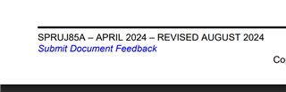

  • Rapeti,
    SPI0_D0 is on pin J2-15. SPI1_D0 is on J6-55. The schematic should always be considered correct vs. the User Guide. Please Submit Document Feedback by clicking this link in the footnote of any page of the User Guide:
