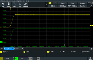

  • The BSL invokation PIN (PA18 -> green)  in regard to NRST (yellow):
    So the BSL should be runinng..

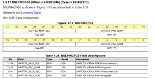

  • Hi Steffen,
    Please check the BSLPINCFG0 register in our Technical Reference Manual. It is a field of NONMAIN, and BSL will scan the UART pin defined by this register. So you may need to change this field if you want to change UART pins. It could be configured in Sysconfig.
  • Hi Pengfei,
    the change of UARTs GPIOs are working. That is not my problem. The problem is the three other GPIOs I want to use.
