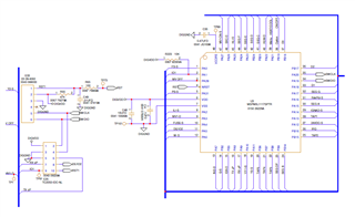

HI,
When I programmed MSPM0L1117, I need to start the application through J-Link to operate normally, otherwise control doesn't work. When control is power down and powerup up again, it doesn't start operation.
I didn't select NMV configuration using System Configurator Tool. I am using J-Link for programming and debugging application. Could you please let us know solution for this issue? It seems control is not booting to execute program.

  • Now I have use GPIO_SOFTWARE_POLL code from the library, and programmed using J-Link, used LED pin from from schematic. It still doesn't work when I power up again. Please let us know solution for this. It works fine when I click START APPLICATION through J-Flash.
    Below is J-Link connection diagram.
  • Note that on launchpad this issue is not seen when I use GPIO_SOFTWARE_POLL to toggle LED. So ensure that XDS and J-Link do the same thing or not.
  • Hi Harshal,
    I think this related to BSL inboke pin.
    PA18 is BSL invoke pin, and if it is high during power up or reset, it will trigger BSL and not run application code.
    Please kindly check your PA18 voltage, and connect with a externall pull-down resistor if it is floating.
    We enable external pull-down resistor in EVM.
