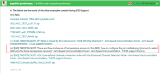

I looked at the following thread issues related to the MCU.

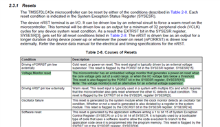

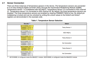

In the relevant manual, it is mentioned that the temperature sensor 3 is used. I ran the routine downloaded in the manual on the TMS570LC4357HDK board, and the result was negative. May I ask where I made a mistake?
The results are as follows:
Another question is, if only temperature sensor 3 is obtained, is it ok to only enable the drive of adc2?
