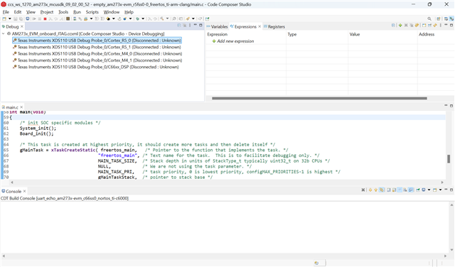

  • Hi Ming,
    I loaded a sample project: hello_world_am273x-evm_c66ss0_nortos_ti-c6000 from the AM273x SDK in CCS.
    I can build it well. However, when I Start Debugging it, I got following error message: IcePick_M_0: Error connecting to the target: (Error -2131 @ 0x0) Unable to access device register. Reset the device, and retry the operation. If error persists, confirm configuration, power-cycle the board, and/or try more reliable JTAG settings (e.g. lower TCLK). (Emulation package 20.2.0.3536).
    What's the reason of above error? How can I fix it? I tried powering cycle the board, but not helpful. Does it relate to the target configuration file?
    Thanks for your help and advice.
    Lin

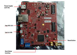

  • Hi Lin,
    For the JTAG to access the AM273x SoC, you will need to set AM273x EVM to "No Boot Mode":
    and XDS_USB (J9) is connected to your PC:
    Ming
  • Hi Ming,
    I changed boot mode to No Boot Mode by adding two jumpers as shown above (before it was 000, no any jumper). Now it's 101.

  • Hi Ming,
    The sample project hello_world_r5ss0-s_nortos works fine now. However, when I try to import hello_work_c66ss0_nortos project, I got message said: No TI C6000 compilers, supporting device evmAM273x' are currently installed!  Where can I find them and how to install them?
    Lin
  • Hi Ming,
    I manually installed the ti-cgt-c6000_8.3.12, now the hello_work_c66ss0_nortos project can be imported and built. However, when I debug it, I get below error message: C66xx_DSP: Error connecting to the target: (Error -6305) PRSC module failed to write to a router register. (Emulation package 12.7.0.00105). Do you have any hint about it? How can I resolve it?
    Also, in your previous replies, what do you mean by "you will need to connect R5F0 first then connect to the C66x core."?
    Thanks again for your continuous support and help.
    Lin

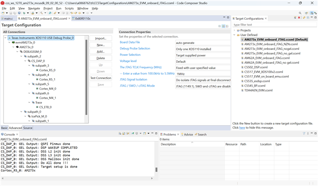

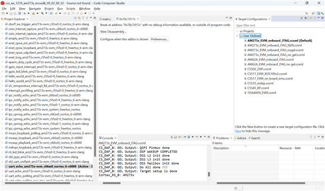

  • Also, looks like the manually created Target Configuration file is not used in the sample project. (the file names are different)

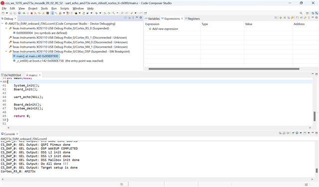

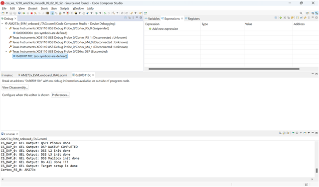

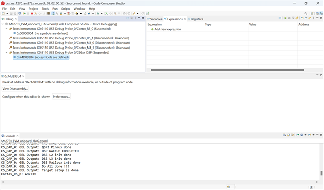

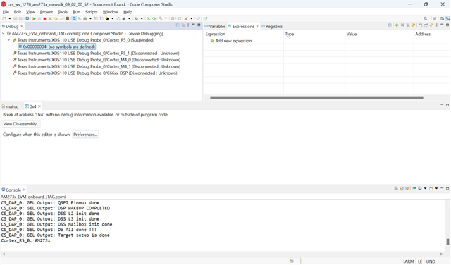

  • Hi Lin,
    To use the manually created target configuration file, you have to show the target configuration files:
    1. CCS --> View --> Target Configurations:
    2. Right click on your manually created target configuration file and select "Launch Selected Configuration"
    3. Right click on the Cortex_R5_0, then select "Connect Target"
    4. Right click on the C66xx_DSP, then select "Connect Target"
    5. Now you can load your application code to the C66xx_DSP. CCS --> Run --> Load --> Load Program --> select the *.out file. After the program is loaded, it will stop at main().
    6. Press the F8 to run the code, or F6 to single step the code.
    The reason to do the above steps is that the C66xx_DSP needs the R5_0 GEL file to initialize, so the direct connect to C66xx_DSP using JTAG will fail.
    Ming

  • Hi Ming,
    I followed your instructions running  the hello_world_c66ss0_nortos sample project and got the similar results as shown in your screenshots. It looks like now the hello_world_c66ss0_nortos sample project works well. Thank you very much for your help and support.

  • Hi Lin,
    I have changed the JTAG TCLK from 5.5Mhz to 1Mhz as the following. It works, although it is very slow.
    Then following the steps I mentioned in my previous post. I got the following result:
    As you mentioned in your post that the 5.5Mhz JTAG TCLK works for you. Why do you need to change it to 1Mhz or 500Khz. It will be extremely slow for load and debug your program.
    Ming
