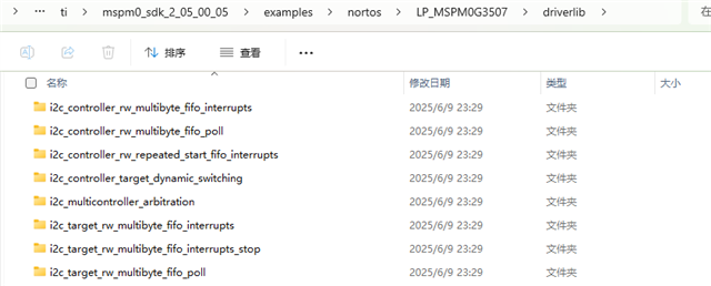

Can we transmit data from one I2C port to another I2C port within the same controller?
Launchpad which I am using is: MSPM0G3507
Thank you
  • Hi Tejal,
    Sure. You could set one I2C as controller and another as slave and just connect SCL and SDA pin together.
  • Do I also need to connect pull-up resistors for I2C communication? and could you provide a simple sample code for setting up I2C communication.
    Thank you,
    Tejal
  • Hi Tejal,
    Yes, you could either use the internal pull-up resistors or external pull-up resistors.
    As for example, you could merge the i2c controller and target example into one project for you application. The interrupt example could be used for i2c target.
  • Hi Pengfei,
    I tried merging the I2C controller and target example, but I am not getting an acknowledgment from the target device. I am also attaching the output which I observed on the logic analyzer.
    Thank you,
    Tejal
  • Which examples did you merge? I expect you'd want to use an interrupt-driven model on the target side.
    Did you change the target I2C address on both sides?
  • Yes I changed the I2C address on both side and also, I am using interrupt driven code on target side, and following 2 examples I merged:
    1) i2c_controller_multibyte_fifo_poll and 2) i2c_target_multibyte_fifo_interrupt
  • Hi Tejal,
    It is correct that you are using the interrupt example for I2C target.
    There are some items you could check:
    • You are writing to address 0x10 from I2C master, have you change the I2C target address as 0x10?
    • Have you pull-up the SCL and SDA pin?
    • For I2C target code, make sure it is completely follow the SDK example, especially for the enabling of interrupt and interrupt handler achievement.
    Pengfei
  • Can you post your resulting (merged) code? Sometimes all it takes is a typo.
    For the target side, the contents of main() should be suitable for a "target_init()" function, except for:
        DL_SYSCTL_enableSleepOnExit();
    This should be removed, since it has a global effect on the program. (It could produce the symptom you're seeing.)
