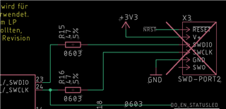

I am using the MSPM0L1304 and want to use pin PA20 (SWCLK) as a digital output. In the SysConfig() “Debug On SWD Pins” is activated.
My main() looks like this:
int main(void) {
  SYSCFG_DL_init();
  if (DL_GPIO_readPins(BTN_PORT, BTN_DI_SWITCH_PIN)){
    DL_SYSCTL_disableSWD();
    DL_GPIO_enablePower(GPIOA);
    DL_GPIO_initDigitalOutput(IOMUX_PINCM21);
    DL_GPIO_enableOutput(GPIOA, DL_GPIO_PIN_20);
    DL_GPIO_setPins(GPIOA, DL_GPIO_PIN_20);
  while (1) { }
In the circuit diagram, I have placed an LED with a series resistor parallel to the SWCLK pin. The LED also pulses during the flash process.
I can't manage to set the SWCLK pin to logic high to supply the LED.
I have read that the debugger may be blocking the interface.
However, I can't manage to set the pin to high even if I just flash.
Perhaps you have a tip for me.
Best regards, C. Zwingmann

    4a. Based on the code given, kindly ensure that the internal pull-down resistor is also set to none since the SWCLK pin has an internal pull-down resistor. Kindly let me know how that goes!
    Regards, Jojo
  • Hello Jojo,
    I have solved the problem.
    I fixed another internal error on my part, then the project ran.
    The “Debug Enable On SWD Pins” is deactivated.
    The following syntax runs:
    void SYSCFG_DL_DEBUG_init(void){
        #ifdef DEBUG_MODE
           delay_cycles(500000000);
        #endif
       SYSCTL->SOCLOCK.SWDCFG = (SYSCTL_SWDCFG_KEY_VALUE | SYSCTL_SWDCFG_DISABLE_TRUE);
    int main(void) {
     SYSCFG_DL_init();
        DL_GPIO_clearPins(GPIOA, DL_GPIO_PIN_20);
    while(1){
    No pull-down had to be set to "None".
    Many thanks for your help!
