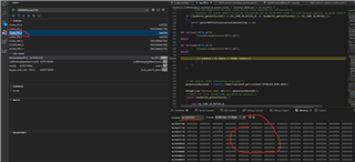

Just after switch from bootloader into Application, when accessed from core0, all of our OCRAM banks (0-5) seem to be initialised as RAM adress 0x702FFFFF is visible from core0:

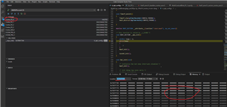

However, when looking at the same memory space from core 2, this memory space shows up as uninitialised:
instead, we can see memory space up to 0x701FFFFF or thereabouts) being initialised:
The same is the case for core3.
This implies that for R5SS0 OCRAM banks 0-5 are initialised OK, but for R5SS1 only OCRAM banks 0-3 are initialised OK.

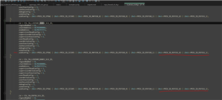

    I've also checked the permissions set on the default hsm image firewalls. In generated syscfg code, it seems the permissions for all L2OCRAM banks are correctly set for access from all cores:

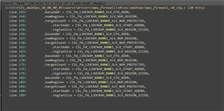

    In the related post you pointed to a bug in gMpuFirewallConfig (in mpu_firewall_v0_cfg.c) where definitions for CSL_FW_L2OCRAM_BANKx_SLV_CFG_ADDR are not set for both banks 4 and bank5 of OCRAM.
    Have added definitions for bank 4 and 5, will generate a test build and report back.
  • Adding definitions for bank4/Bank5 OCRAM fixed the issue. We also had to add in firewall config for the RL2 cache as the application was running from XIP and so configured with one.
