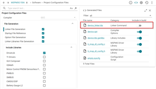

  • Hi Philip,
    You can also click on exclude in build, shown as below:
    Then copy the generated lds files and paste it into main project path.
    B.R.
