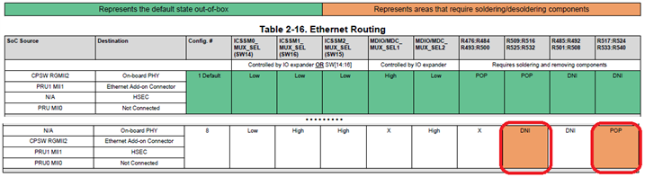

I am trying to enable Automotive Ethernet add-on Board (DP83TG720-EVM-AM2) on AM263px Control Card (TMDSCNCD263P PROC159A).
I re-soldered zero-ohm resistors on the control card according to Config. #8 in Table 2-16 from the control card User Guide.

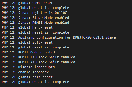

I am trying PHY loopback test from  Enet CPSW Loopback Example.

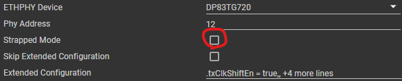

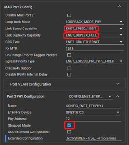

I made changes in the Sysconfig file from the example as described here.

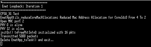

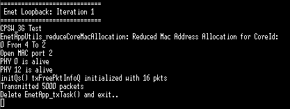

As a result, the transmission fails.
While checking the signals on the add-on PHY board, I observe 25 MHz on Tx clock pin.
As I understood from PHY documentation, this clock is provided by MAC, and it should be 125 MHz. Therefore, it looks like the problem is on MAC side.
I would be thankful for any suggestions for further debugging or proper configuration.

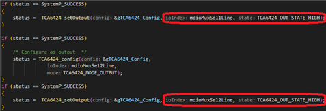

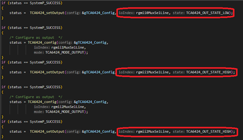

    Can you also confirm the configuration of your SW14:16 on-board switches?
    Shaunak
  • Hi Shaunak,
    The code generated by Sysconfig correctly sets up the signals, which are controlled by SW14:16.
    I have checked the set voltage levels at corresponding pins, they are correct.
    In addition, I have tried to set SW14:16 manually, and it does not make any change.
    The code generated by Sysconfig connects CPSW MDIO bus to both on-board and add-on PHYs.
    As I understand, this should not be a problem, since the PHYs have different IDs.
    Are there any other things to check?
    Just wanted to check if:
    SW14 - LOW
    SW15 - HIGH
    SW16 - HIGH
    Also, In the PinMux in Enet (CPSW), do you set it as RGMII?
    Also, in the top level board in Enet (CPSW), Do you select Automotive add-on-board?
    Shaunak

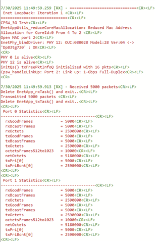

    This can also be some other issue with board, I do the same steps on my end and it works

  • Hi Nikolay,
    I tried running the same and it worked. The only changes I did were w.r.t to the PHY address (apart from the documentation)
    When you run your application, you will see the PHY Alive come up with the address. In my case I saw PHY0 and PHY8, but my Syscfg EthPhy address was configured as 12. You can check the same once as I see in your syscfg as well the PHY address is 12. In your application log, if you see "PHY8", Change this address to 8 from 12 and re-build and try again. Let's see if this solves the issue
    Shaunak

  • Hello Shaunak,
    I have tried a new set of AM263Px-CC + Auto PHY. However, exactly the same issue remains. I need to debug further.
    1) If you know how to share a binary here, could you please share yours?
    2) Is your HW configuration same as config. #8 in the table? No other changes in HW?

  • Hi Shaunak,
    Thanks for suggestion, unfortunately it didn't help.
    1) I tried all the options for .MasterSlaveMode field as you suggested, neither of them worked.
    2) I was able to link up MAC and Auto-PHY after unchecking "Strapped Mode" in SysConfig.
    In this case, MAC transmits data, but it is not received after loopback.
    While checking the signals, I still see 2.5 MHz Tx clock and 125 MHz Rx clock.
    3) I checked RGMII2_STATUS register values afer link-up event.
    Working case (on-board PHY):
    Non-working case (addon Auto-PHY):
    Looks like configuration has not been applied to MAC in case of Auto-PHY.
    4) I enabled debug log in the PHY part of the driver.
    It does not show anything wrong. Looks like there are no problems with MDIO communication and PHY itself.
    Is there anything else to check, without digging into the driver?

  • phy_loopback.ziphttps://e2e.ti.com/cfs-file/__key/communityserver-discussions-components-files/908/enet_5F00_cpsw_5F00_loopback_5F00_phy_5F00_end_5F00_am263px_2D00_cc_5F00_r5fss0_2D00_0_5F00_freertos_5F00_ti_2D00_arm_2D00_clang.out
    Hi Nikolay,

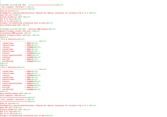

    I have attached my project. I have tested it on my side on CC board and it is working. It is in zip format. Import it in CCS and build the project.
    I have also attached my .out file.
    I am able to see the outputs. Please see the screen snip below
    Can you check the following in your setup,
    1. Can you reconfirm if SW14, SW15 and SW16 switches on the control card are LOW, LOW and LOW respectively.
    2. Have you made any changes in PHY add on board or on the EVM?
    3. The sysconfig file will be available in the project. Can you check it with yours as well.
    Aswin
  • Hi Aswin,
    Thanks a lot for investigating this issue. I flashed your binary, but it did not work on my side.
    Therefore, it is clear now, that my issue is related to HW, since the same SW is working for you.
    What is your HW configuration? Did you make any changes on the CC board or PHY add-on board?
    Answering your questions:
    1. I set the switches as you wrote, but it did not help.
    2. No changes on the PHY add-on board.
    On the CC board I re-soldered zero-ohm resistors according to config. #8 from the table in EVM user guide.
    3. I could not check the Sysconfig file directly (the sources in your project are linked from SDK folder).
    However,  .c and .h files generated by Sysconfig in your project are identical to mine.

  • Hi Nikolay,
    The project that you have sent me is working on my side. Here is the output of the debug build.
    The SW pins should be like
    - SW14 : LOW
    - SW16 : HIGH
    - SW15 : HIGH (The switch orientation inverted compared to SW14 and SW15)
    I apologize for my mistake in the earlier message when I said all should be low.

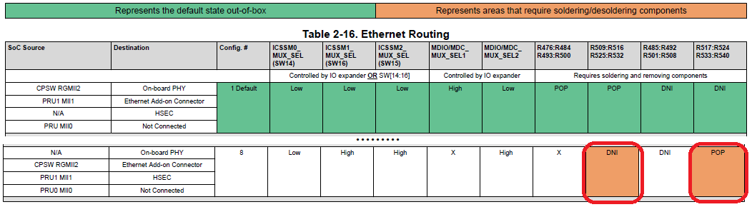

    Regarding the resistor configurations,
    On my setup only the following resistors were populated( with zero ohm resistors)
    R517: R524 and R333: R540
    Aswin

  • Hi Aswin,
    Yes, R509:R516 DNI is done. My configuration is as follows:
    DNI - R509:R516, R525:R532;
    POP - R517:R524, R533:R540.
    In your configuration, you got both PHY 0 and PHY 12 alive logs. So it may not be an problem, since your configuration is working.
    I will try your configuration (only populate R517: R524 and R533: R540), and update.

    My initial non-working configuration was #8 from Table 2-16 from CC board user guide:
    I changed it to the configuration, which Aswin shared: soldered back R509:R516, R525:R532. After this change auto-PHY is working well.
    I do not know yet, why it helped. According to the schematic, it should not make any difference.
