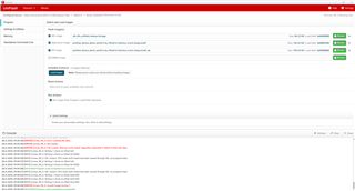

I'm currently working with the Industrial Communication SDK (10_02_00_15) and trying to run the Profinet Device Demo on an AM261x LaunchPad (LPE2) board. However, I'm encountering an issue during the flashing process.
When I attempt to flash the demo to the board, I get the following output in the debug console:
Cortex_R5_0: AM261x
Cortex_R5_0: Board Selected : LP
Cortex_R5_0: Run failed...
Cortex_R5_0: Trouble Removing Breakpoint with the Action "Remain Halted" at 0x7000d80c: (Error -1066 @ 0x7000D80C) Unable to set/clear requested breakpoint. Verify that the breakpoint address is in valid memory. (Emulation package 20.2.0.3536)
Cortex_R5_0: File Loader: Memory write failed: Timed out waiting for target to halt while executing am261x_lp_flasher.out
I'm using CCS 20.2.0.12 with the recommended version of the Emulation Package. I see the same issue on a second AM261x-LP board.
Any help would be greatly appreciated!
