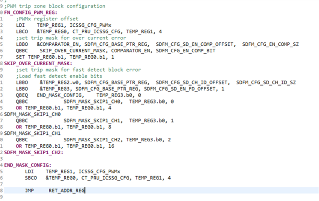

1) The PRU ICSS PWM TZ_OUT signal (for Fast Detect) is an active-high signal. What do I need to change at the SDFM firmware to invert the polarity of the PRU ICSS PWM TZ_OUT signal?
2) It seems that the Fast Detect only works if the Fast Detect option is enabled for CH0. If I disable the Fast Detect for CH0, it no longer works for the other channels. Why is that, and what do I need to change to make it work?

    Yes, there is a bug: the PWM trip register is configured only when Channel 0 is enabled! Please update FN_CONFIG_PWM_REG with the code below to remove the dependency on Channel 0
    OK, that means for the Fast Detect the complete path (SDFM-firmware -> PRU PWM TZ module -> chip output) is hardware-driven?
    Yes, the SDFM firmware doesn't perform any comparisons; it simply enables fast detect. All comparisons are handled by the fast detect block.
