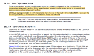

    I am also suspecting this in between the transfers the CS line will get toggle like as show below:
    To prevent this, we should use CSHOLD bit:
    If it is not due to chip-select inactive between the transfers then try to make sure you configured these delays as zero like shown below:
    If these delays already zeros, then maybe we cannot further decrease this 50 to 60nS, however try also with DMA once instead of manual CPU write.
