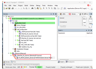

I am working on 8 Analog input, but Problems I can not update my EDS file.  I tried 100 time same problems.
, and It not work!!!!!!!!!!!!!!!!!!!!!!!!!!!!!!!!!!!!!!!!!!!!!!!!!!!!!!!!!!!

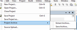

1)  I installed first time and I save it , I ran this Codesys programs , Save Archive to fews files , worked , no problems. (work good only no change on device)
2) When remove and ad device ,marked red , run again it will not turn on and off LED  (Not work )
I used ChatGPG , but can not solve problems.

  • I verified and tested with Orignal TI Ethernet_IP_demo , and ESD file from TI. on New hardisk and new Codesys ver 21. Target 14.0  . It will have same problems only work first time installed . I can shut down computer save to new fille no problems. But when I removed or deleted Ethernet IP scanner or EDS file. Run it . it will no work!!!!!!!!!!!!!!!!!!!!!!!!!!!!!!!!!!
  • I means , Add new device same EDS file to Ethernet. It will not turn on/Off LEDs.  (I see adapter on , but  LED will not on /off .
  • Here is TI EDS file , I used
    All programs 100 % from Ti , No modifed code will worked only first installed.
    or  My new  EDS file will work with TI CCS code or My new CCS code only first installed

  •  Answer # 1 I am working on 8 Analog input , I2c ,DAC . I need to change parameter or assemby in  EDS file . So  I need to change ESD file in Codesys. But every I change , it is not active the adapter with means it is not link to hardware. ( How do I verify  problems, If I use  original Internet_IP_demo program, and ESD file, Copy ESD file to file1.EDS file2.EDS or file3.EDS , It means I can delete file1  and add device file2 or file3 and it should work, but it not work!!!! ). If it not work then I can not run my EDS file.
    Note file1.ESD file .... file2.EDS  all of this file when you run LED on LP-AM243 (i.e., the LEDs must  blink) but it not !!!!!!
