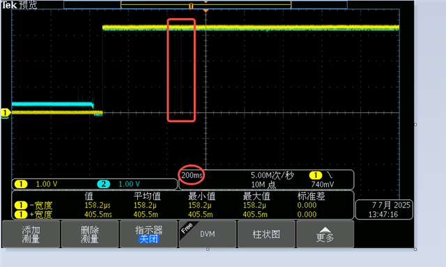

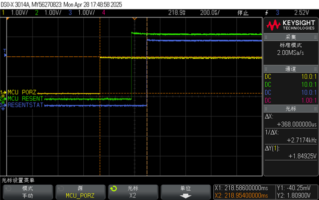

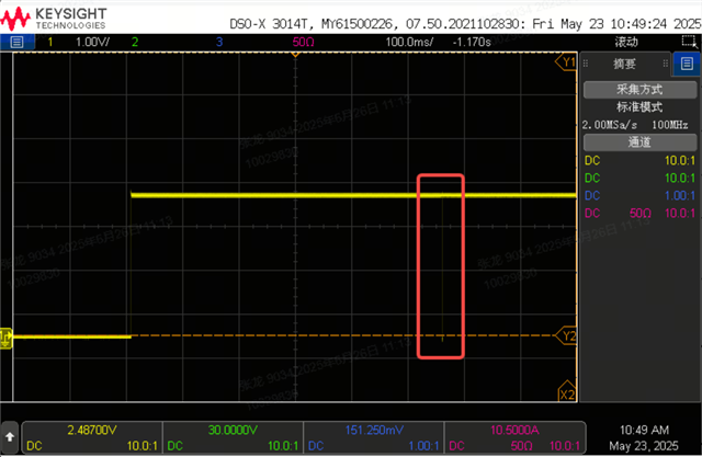

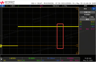

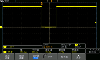

   We found in our testing that after the AM2432 MCU-PORz signal is released, the RESETSTATz and MCU-REETSTATz will be pulled low, but the RESETSTATz low level time tW (158us)is less than the 4040 * S (161.6us)required in the datasheet.What's the solution to this problem? What are the implications?
Figure 1 the RESETSTATz singal POWER UP
Figure 2 we test  RESETSTATz POWER UP (zoom enlarge)

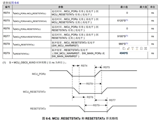

Figure 3 AM2432 datasheet specifications
  • Hi Zhannglongc,
    The RESETSTAT low duration is more like a parameter that the SoC must be able to provide, rather than a requirement from the user. It is up to you if that small deviation is an issue for the external circuitry that uses/monitors RESETSTAT .

  • Hi :

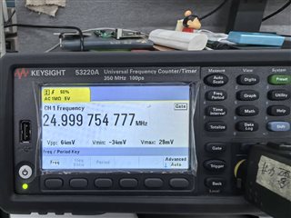

        1、we  tested our System clock , the frequency Tolerance <30ppm,according we test tW=158us caculate the S is 39.1ns,which beyond 30 ppm,in addition to ,we test RST8 is meet  specifications.
        2.Our design the MCU_PORz is controled by RESET IC,we monitoring 0.85V,when 0.85V power good the signal of RESET be releast ,the MCU_PORZ synchronization be releast,so the MCU_PORz did't  be pulled low,I think MCU_RESETSTATz and RESETSTATz been warm reset.

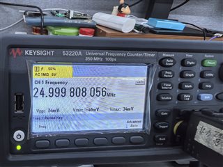

  • Hi:

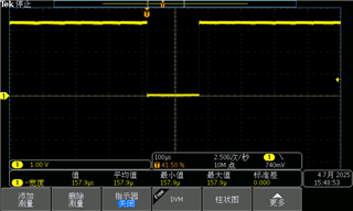

        Any progress on this issue?I used a frequency meter to test the clock accuracy of my module and the parameters of RESETSTATz RST9 as shown below:
    Figure 1 1CPU_CLK and  RESETSTATz RST9=157.5us
    NOTE:The RST9=161.6012us calculated based on the test clock frequency is obviously a big error from the RST9 of my test RESETSTASz signal, so it's not a clock precision effect.
    2CPU_CLK
    Figure 2 2CPU_CLK and  RESETSTATz RST9=157.9us
    NOTE:The question is the same as above

    "RESETSTATz RST9=157.9us  being shorter  than expected in datasheet RST9=161.6012us " - does this affect something in your design? For example any other devices than the Flash memory. I can see from the Flash datasheet that the chip requires min. 1 us reset signal for proper internal reset therefore there is no problem for Flash.
  • Hi Stanislav Stilyanov:
         "RESETSTATz RST9=157.9us is meet to my device flash reset requirens,but our company test team thinks that RESETSTATz low level time does not meet the AM2432 datasheet requirements(161.6012), we need to give an explanation of what causes this parameter does not meet the specification, so I need your help, I don't think this has anything to do with my design, it's an internal decision of the chip.

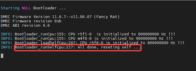

    What is the initial software you are running , if any?
     I checked the reason for this reset signal, and saw that the am2432 user manual states that a hot reset is performed roughly after a few hundred ms of MCU_PORz release (this time is what I found in my testing)
    I think this should not be the case. I think this is an internal reset to R5 CPU only and this reset should not be displayed on RESETSTATz pin. Also, I don't observe RESETSTATz assertion on EVM.
        we have run the initial software,in addintion to i try only down null bootloader on my device ,also i can capture RESETSTATz singnal,but i can't capture RESETSTATz singnal on EVM(only down null bootloader),so So I'm also confused as to what the difference is between the two and why the results are different.

  • Hi Zhanglong,

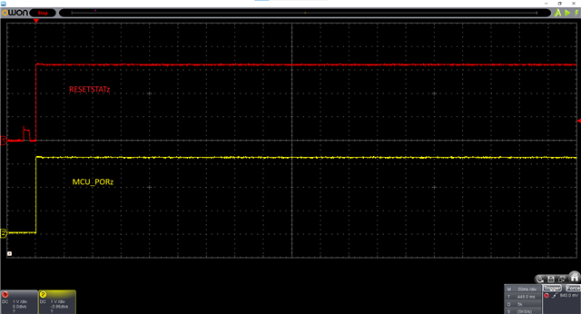

    Can you please capture RESETSTATz along with MCU_PORz? Like below figure?
    Stan
  • Hi:
       I capture MCU_RESETSTATz and RESETSTATz along with MCU_PORz,As shown in the figure below.
  • Hi ,
    On your last capture I can't see the low RESETSTATz pulse from your initial question:
    Can you please re-test RESESTATz + MCU_PORz with the low pulse visible?

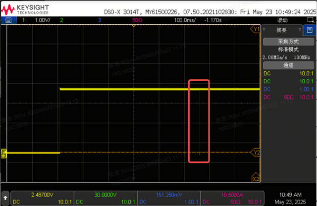

  • Hi:
       the low RESETSTATz pulse occur roughly 500 ms after RESENTSTATz is powered up, so the waveform above can't capture.
    Did you measure this waveform in EVM, and did EVM download the bootloaders? If there is no bootloaders, the low level of RESETSTATz is not captured.
  • Hi Zhanglong,
    Ok, then this is a software-generated reset.

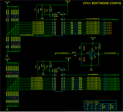

    What bootloader/OS you are using?
    Can you share the BOOTMODE pin settings?
    Stan
  • Hi:
    Yes,I also think this is a software-generated reset ,Did you find out why you didn't meet the specs?
    Our bootloader as as shown below,our os:Real Time-Thread
    Our  bootmode pin set as as shown below,Primary bootmode is OSPI,and back up bootmode is UART.

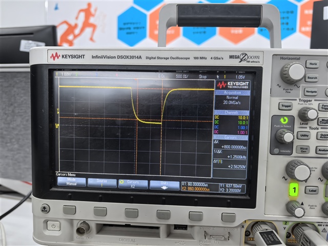

    In the mean time if you have a provision to do a cold reset, can you do a fast reset - just press and remove and a long press reset and measure the RESETSTATz output.
     In the mean time we can't do a cold reset,However, we perform a hot reset during a firmware upgrade, and the waveform is shown below, because the RESET_REQz pin has a filter capacitor, the falling edge of the signal is relatively slow.
  • Hi Zhanglong,
    Thank you.
    I understand the measurement you are seeing is during MCU_PORz.
    Noted. Cased on the waveform it looks like the time measurement was after the MCU_PORz goes high
    A warm reset should be Ok.
    The LVCMOS input slew is expected to be less than 1000ns. For the reset inputs, the slew is recommended to be much less (~100ns) since the internal reset could glitch.
    With the slow ramp, the RESETSTATz measurement may not be repeatable - can you measure the RESETSTATz output after pressing the RESET_REQz for a short time - some ms and long time - ~ 2 seconds and see if you see any difference the the RESETSTATz timing.

  • Hi Zhanglong,
    Can you unmount the capacitor and measure the RESETSTATz again?

    2. We don't know because RESETSTATz is internally generated and should be 4040 * 25-MHz clock cycles time, but customer is seeing slightly less. This should not be an issue because they only use RESETSTATz to reset theit flash memory which requires only 1-us of reset asserted.
    Yes, I agree , the shorter reset duration time should be addressed internally.\ and may require datasheet update or else.
