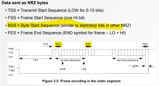

  • 1. How to set the appropriate value for gdStaticSlot? Is it calculated based on gPayloadLengthStatic? The unit of gdStaticSlot is mt, so what is the relationship between mt and double bytes?
    gdStaticSlot is the duration of a static slot (4~661 MT). All static slots consist of an identical number of gdStaticSlot macroticks. It is defined by user. The configuration of the static slot length gdStaticSlot must assure that the frame and the channel idle delimiter and any potential safety margin fit within the static slot under worst-case assumptions.
    It's unit is Macrotick which is composed of an integer number of microticks.
    gPayloadLengthStatic is the payload length of a static frame (0~127 words).
    The payload data word is equal to 2*(8 gdBit + cdBSS) = 20 gdBit, where the cdBSS is the duration of the byte start sequence, it is 2gdBit (bit time)
    The FlexRay Frame consists of TSS, FSS, BSS< FES, and header and trailer.
    aFrameLengthStatic =  gdTSSTransmitter[gdBit] + cdFSS[gdBit] + 80 gdBit + gPayloadLengthStatic[2-byte-word] * 20 gdBit + cdFES[gdBit]
    For 10MBit/s bit rate, the gdBit is typically 1us.
