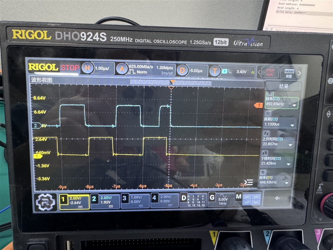

AM2612: Why do PWMA and PWMB generated by PWM always have random overlapping high parts at the end of timing?
Part Number: AM2612
Dear TI experts,

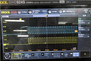

We now use AM2612 r5f 4 channel PWM module to cooperate with high-speed relay output.
We hope generate PWMA&B pulse for a specified period on GPIO output is closed or opened and the waveforms of PWMA and PWMB are exactly inverted.
Now the waveform has a problem like the following picture: the yellow is PWMA, the blue is PWMB. There are random overlapping high parts when the timer clock is timeout, which can't be permitted.
But I don't know how to prevent it.
Please find the attachment for the example.syscfg file.

For timer clock function code of stop PWM is as follows:
void PWMTimerCb(ClockP_Object *clkInst, void *arg)
uint32_t temp = (int)arg;
cnt ++;
#if 1
/* If EnableMask = 1&DisableMask = 1, set PWM disable */
if( temp & 1 )
EPWM_setActionQualifierAction(HSHB1_BASE_ADDR, EPWM_AQ_OUTPUT_B, EPWM_AQ_OUTPUT_LOW, EPWM_AQ_OUTPUT_ON_TIMEBASE_UP_CMPB);
EPWM_setDeadBandDelayPolarity(HSHB1_BASE_ADDR, EPWM_DB_FED, EPWM_DB_POLARITY_ACTIVE_HIGH);
EPWM_setActionQualifierAction(HSHB1_BASE_ADDR, EPWM_AQ_OUTPUT_A, EPWM_AQ_OUTPUT_LOW, EPWM_AQ_OUTPUT_ON_TIMEBASE_UP_CMPA);
if( temp & 2 )
EPWM_setActionQualifierAction(HSHB2_BASE_ADDR, EPWM_AQ_OUTPUT_B, EPWM_AQ_OUTPUT_LOW, EPWM_AQ_OUTPUT_ON_TIMEBASE_UP_CMPB);
EPWM_setDeadBandDelayPolarity(HSHB2_BASE_ADDR, EPWM_DB_FED, EPWM_DB_POLARITY_ACTIVE_HIGH);
EPWM_setActionQualifierAction(HSHB2_BASE_ADDR, EPWM_AQ_OUTPUT_A, EPWM_AQ_OUTPUT_LOW, EPWM_AQ_OUTPUT_ON_TIMEBASE_UP_CMPA);
if( temp & 4 )
EPWM_setActionQualifierAction(HSHB3_BASE_ADDR, EPWM_AQ_OUTPUT_B, EPWM_AQ_OUTPUT_LOW, EPWM_AQ_OUTPUT_ON_TIMEBASE_UP_CMPB);
EPWM_setDeadBandDelayPolarity(HSHB3_BASE_ADDR, EPWM_DB_FED, EPWM_DB_POLARITY_ACTIVE_HIGH);
EPWM_setActionQualifierAction(HSHB3_BASE_ADDR, EPWM_AQ_OUTPUT_A, EPWM_AQ_OUTPUT_LOW, EPWM_AQ_OUTPUT_ON_TIMEBASE_UP_CMPA);
if( temp & 8 )
EPWM_setActionQualifierAction(HSHB4_BASE_ADDR, EPWM_AQ_OUTPUT_B, EPWM_AQ_OUTPUT_LOW, EPWM_AQ_OUTPUT_ON_TIMEBASE_UP_CMPB);
EPWM_setDeadBandDelayPolarity(HSHB4_BASE_ADDR, EPWM_DB_FED, EPWM_DB_POLARITY_ACTIVE_HIGH);
EPWM_setActionQualifierAction(HSHB4_BASE_ADDR, EPWM_AQ_OUTPUT_A, EPWM_AQ_OUTPUT_LOW, EPWM_AQ_OUTPUT_ON_TIMEBASE_UP_CMPA);
#endif
PWM start code:
if( j == 0 )
EPWM_setActionQualifierAction(HSHB1_BASE_ADDR, EPWM_AQ_OUTPUT_B, EPWM_AQ_OUTPUT_HIGH, EPWM_AQ_OUTPUT_ON_TIMEBASE_UP_CMPB);
EPWM_setActionQualifierAction(HSHB1_BASE_ADDR, EPWM_AQ_OUTPUT_A, EPWM_AQ_OUTPUT_HIGH, EPWM_AQ_OUTPUT_ON_TIMEBASE_UP_CMPA);
EPWM_setDeadBandDelayPolarity(HSHB1_BASE_ADDR, EPWM_DB_FED, EPWM_DB_POLARITY_ACTIVE_LOW);
else if( j == 1 )
EPWM_setActionQualifierAction(HSHB2_BASE_ADDR, EPWM_AQ_OUTPUT_B, EPWM_AQ_OUTPUT_HIGH, EPWM_AQ_OUTPUT_ON_TIMEBASE_UP_CMPB);
EPWM_setActionQualifierAction(HSHB2_BASE_ADDR, EPWM_AQ_OUTPUT_A, EPWM_AQ_OUTPUT_HIGH, EPWM_AQ_OUTPUT_ON_TIMEBASE_UP_CMPA);
EPWM_setDeadBandDelayPolarity(HSHB2_BASE_ADDR, EPWM_DB_FED, EPWM_DB_POLARITY_ACTIVE_LOW);
else if( j == 2 )
EPWM_setActionQualifierAction(HSHB3_BASE_ADDR, EPWM_AQ_OUTPUT_B, EPWM_AQ_OUTPUT_HIGH, EPWM_AQ_OUTPUT_ON_TIMEBASE_UP_CMPB);
EPWM_setActionQualifierAction(HSHB3_BASE_ADDR, EPWM_AQ_OUTPUT_A, EPWM_AQ_OUTPUT_HIGH, EPWM_AQ_OUTPUT_ON_TIMEBASE_UP_CMPA);
EPWM_setDeadBandDelayPolarity(HSHB3_BASE_ADDR, EPWM_DB_FED, EPWM_DB_POLARITY_ACTIVE_LOW);
else if( j == 3 )
EPWM_setActionQualifierAction(HSHB4_BASE_ADDR, EPWM_AQ_OUTPUT_B, EPWM_AQ_OUTPUT_HIGH, EPWM_AQ_OUTPUT_ON_TIMEBASE_UP_CMPB);
EPWM_setActionQualifierAction(HSHB4_BASE_ADDR, EPWM_AQ_OUTPUT_A, EPWM_AQ_OUTPUT_HIGH, EPWM_AQ_OUTPUT_ON_TIMEBASE_UP_CMPA);
EPWM_setDeadBandDelayPolarity(HSHB4_BASE_ADDR, EPWM_DB_FED, EPWM_DB_POLARITY_ACTIVE_LOW);
LY
  • Hi Yang
    Do you just want two pwm's inverted to each other or are their other requirements as well? and do they need to be dependent on each other or can we showcase the above scenario controlling both pwm's independently?
    Akshit
  • Hi Akshit,
    Yes, we want two PWM's inverted to each other. Besides that, we also need dead band for about 10% between PWMA & B.
    PWMA & B high at the same time is forbidden.
  • Thanks for the info, I am trying to reproduce and get a running instance of your setup.
    Let me get back to you asap with some working design and code.
    Thank you for your patience!
    Akshit
  • Hi Yang
    PFA the CCS project for replicating your requirement on AM261x-LP
    empty_am261x-lp_r5fss0-0_nortos_ti-arm-clang.zip
    This program will output the following:
    where we can see both PWM's are active high at mutually exclusive times with a 10% deadband between each.
    Akshit
  • The issue now is not how to generate the correct PWM waveform, but how to properly stop the PWM without producing a waveform where both PWMA and PWMB are high at the same time.
  • Got it!
    in the same example, you can see I used the
    SOC_setMultipleEpwmTbClk(gEpwmTbClkSyncEnableMask, FALSE);
    API to gate the tbclk, and used
    /* Ungate the EPWM clock after the configurations are done */
    SOC_setMultipleEpwmTbClk(gEpwmTbClkSyncEnableMask, TRUE);
    to ungate the tbclk, so I just modified the example to run for 10 seconds and then gate the clocks to stop the pwm's like this:
    /* Gate the EPWM clock for configurations */
    EPWM_setTimeBaseCounter(gEpwmBaseAddr, 0);
    EPWM_setTimeBaseCounterMode(gEpwmBaseAddr, EPWM_COUNTER_MODE_UP);
    ClockP_sleep(10);
    This gave me the following output which should satisfy your requirements

    At the beginning of PWM coding, I think SOC_setMultipleEpwmTbClk() is the PWM function switch.
    As long as the configuration is properly done in syscfg, set SOC_setMultipleEpwmTbClk to 1 will start it, and set it to 0 will turn it off. And PWMA&B should be low when PWM is stopped.
    But actually it isn't. Like your picture about channel 0&1, channel 0 is high when PWM is stopped.
    Then I have to force PWMA&B to low level before PWM is stopped by calling EPWM_setActionQualifierContSWForceAction(low);
    And then the problem will occur but not 100 percent.
    Could you please try to keep PWMA&B low after PWM is stopped?

  • Yes, this time you are right. My original PWM setting and stopping is same as yours. PWM stopping have no problem, but another problem exists.
    Sometimes PWMA&B are both high when PWM starting. In order to solve the problem, i changed code to call EPWM_setActionQualifierAction().
    No matter how it's modified, whether at the beginning or the end, there will always be a situation where both PTMWA and B are high at the same time.

    Blue is PTMW B, yellow is PTMW A.

  • Hi Yang
    Apologies for the delay, have you been able to make some progress on this issue?
    I'll assign this to a SW expert for more help.
    Akshit
  • Hi Akshit,
    Anyway, I was unable to use the dead band module mechanism to control the start and stop of the PWM correctly.
    Finally, I start or stop the PWM output waveform by forcing the AQ output disable or low.
    During the test, there’s still an issue left:
    At the beginning, I configured channel 1-EPWM3, 2-EPWM2, 3-EPWM1, 4-EPWM0,I found channel 1&2 PWM outputs are correct, but 3&4 PWM outputs sometimes keep High abnormally.
    Then I changed the channel sequence in syscfg: channel1-EPWM0, 2-EPWM1, 3-EPWM2, 4-EPWM3, all channel PWM outputs are correct.
    I don't know why. It seems there are some affection of operation sequence of different EPWM channel.
    Please find the attachment for example.syscfg

    if( temp & 2 )
    EPWM_setActionQualifierContSWForceAction(HSHB2_BASE_ADDR, EPWM_AQ_OUTPUT_A, EPWM_AQ_SW_OUTPUT_LOW);
    EPWM_setActionQualifierContSWForceAction(HSHB2_BASE_ADDR, EPWM_AQ_OUTPUT_B, EPWM_AQ_SW_OUTPUT_LOW);
    if( temp & 4 )
    EPWM_setActionQualifierContSWForceAction(HSHB3_BASE_ADDR, EPWM_AQ_OUTPUT_A, EPWM_AQ_SW_OUTPUT_LOW);
    EPWM_setActionQualifierContSWForceAction(HSHB3_BASE_ADDR, EPWM_AQ_OUTPUT_B, EPWM_AQ_SW_OUTPUT_LOW);
    cnt ++;
    if( temp & 8 )
    EPWM_setActionQualifierContSWForceAction(HSHB4_BASE_ADDR, EPWM_AQ_OUTPUT_A, EPWM_AQ_SW_OUTPUT_LOW);
    EPWM_setActionQualifierContSWForceAction(HSHB4_BASE_ADDR, EPWM_AQ_OUTPUT_B, EPWM_AQ_SW_OUTPUT_LOW);
    SOC_setMultipleEpwmTbClk(temp, FALSE);
    LY
  • Hi Yang,
    I appreciate your patient here, our expert in this thread is out of office. We can move forward and fix the issue quickly.
    Your start/stop method depends on AQ continuous software force and per-ePWM TBCLK gating. That’s fine, but it only works deterministically if all ePWM modules use the same “reload mode” for AQ software force. In your SysCfg, EPWM3 has
    epwm3.epwmActionQualifier_continousSwForceReloadMode               = "EPWM_AQ_SW_IMMEDIATE_LOAD";
    while the others (HSHB1–3) appear to be left at the default (reload on TBCTR = ZERO). When RLDCSF ≠ IMMEDIATE, writes to AQCSFRC (your force LOW/DISABLE) don’t take effect until a counter event. If TBCLK is stopped, that event never comes-so your last write can “arm” a change that unpredictably latches when you later start the clock. Depending on TBCTR’s phase when TBCLK restarts, the output can sit HIGH until the first qualifying event occurs. This exactly matches “Ch1&2 ok, Ch3&4 sometimes stick HIGH” and why changing channel order fixed it.
    Masoud
