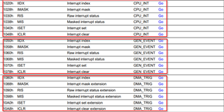

  • There are 3x different RIS registers. If you breakpoint at the second setPins call, I expect you'll see that DMA_TRIG.RIS has MEMRESIFG0=0, but CPU_INT.RIS has MEMRESIFG0=1. This is also consistent with your code's behavior.
  • Hi…sorry I am being dumb, I use dma ris in the loop so why does the dma not clear it the trm above says it dies ???
  • The definition for DL_ADC12_getRawInterruptStatus looks like:
    __STATIC_INLINE uint32_t DL_ADC12_getRawInterruptStatus(
        const ADC12_Regs *adc12, uint32_t interruptMask)
        return (adc12->ULLMEM.CPU_INT.RIS & interruptMask);
    i.e. it looks only at CPU_INT.RIS. By contrast you get to DMA_TRIG.RIS with:
    __STATIC_INLINE uint32_t DL_ADC12_getRawDMATriggerStatus(
        const ADC12_Regs *adc12, uint32_t dmaMask)
        return (adc12->ULLMEM.DMA_TRIG.RIS & ~(dmaMask));
    [That "~" sure doesn't look right, does it? I wonder if anyone has ever used this function.]
    In practice, the RIS bit definitions for the (multiple) RIS registers in each peripheral are the same (also IMASK/ICLR/etc), but named differently (CMSIS requirement), so (ADC12_DMA_TRIG_RIS_MEMRESIFG0_MASK == ADC12_CPU_INT_RIS_MEMRESIFG0_MASK); using an alternate bit name doesn't reference a different RIS register.
    [Edit: In my suggested code above, I didn't notice that you were using the DMA_TRIG_RIS definition -- I just copied what you had. But it would still work.]

  • "the RIS bit resets after each DMA". The key is: Which RIS[:MEMRESIFG0] bit? There are 3x RIS:MEMRESIFG0 bits in the ADC. Observed behavior is that the DMA only clears 1x of them, and that one is not the one you're looking at. (If it were clearing all 3x, it would happen too fast for your loop to see it high and your code would have acted differently.)

    Regarding your question on DMA, I want to jump in and add some comments.
    M0 supports three different EVENT system, the CPU_INT is used for CPU interrupt request.
    The second is GEN EVENT, which used for peripheral trigger, such as GPIO trigger ADC by event system.
    The last one is DMA EVNT, so that DMA will clear this by hardware if DMA transfer happens.
    As for ADC conversion status monitor, normally you are polling the CPU_INT RIS, and then you should clear the CPU_INT RIS, as it will not be cleared by DMA.
    B.R.
    Sal

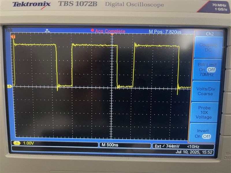

    BUT..when I look at CCK on a 'scope, hard to understand why CCK is high for over a microsecond ?
    DL_ADC12_setSampleTime0(ADC12_1_INST,15); //2 = 50 ns
    is good, I can modulate CCK high by changing above.

    In my case ULPCLK is 25 ns, so above is 100 ns.
    Sample time time is 375 ns from above also.
    I also have this case:
    (C) When ADCCLK is sourced from ULPCLK, the synchronization delay (tsync) is bypassed and the SAMPLE signal gets asserted with the ADC Trigge
    And nine clock cycles for ADC 8 bit conversion including write to memres0.
    So I think all that takes; 100ns + 300ns + 9*25ns = 625 ns
    And then take CCK low....
    Seems to be a large discrepancy..
  • All I can think of is that the DMA is interfering with the CPU bus (polling) activity. Reading TRM Chapter 5 it's never been clear to me whether the CPU or DMA gets priority for bus activity (and at what granularity).
    A quick (maybe) experiment might be to remove the line of code that enables the DMA channel (the DMA requests and data just get lost) and see if your waveform changes.
