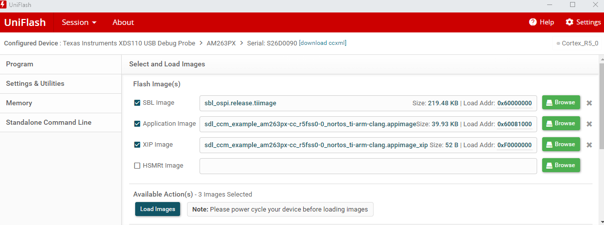

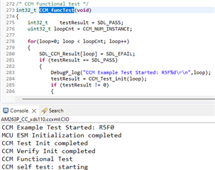

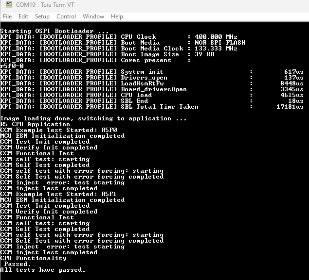

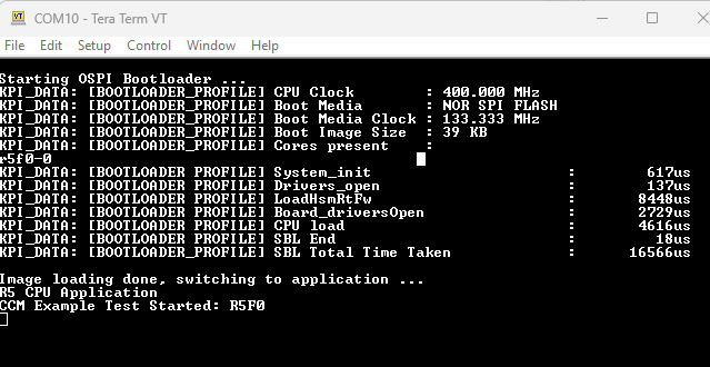

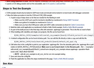

I am working with the sdl_CCM_example provided in the MCU+SDK version 10.02.00.15 on an AM263Px device. When I run the sdl_ccm_example in QSPI boot mode. The image is flashed successfully, and the application begins execution.
However, the control gets stuck right after printing the message CCM_Example_started . The lockstep error detection tests are never executed beyond this point. Attached the image.
