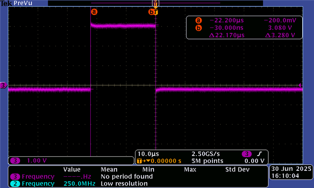

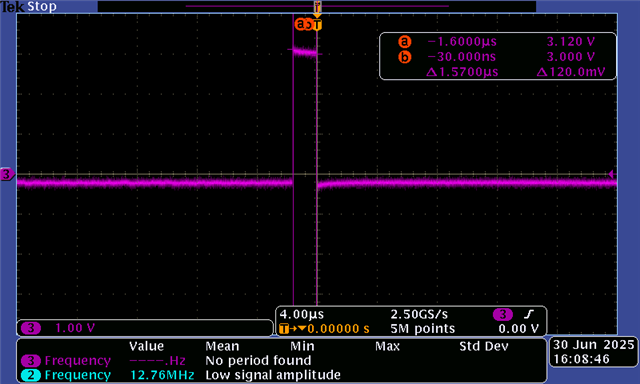

I modify the example in M0 SDK to test the MATHACL, there are 2 example i used with the same code for div operation, the time consumption are quite differen. Could you help to check what's the configuration difference between these 2 and how to make sure the MATHACL is enable and work properly?
iqmath_mathacl_ops_test_LP_MSPM0G3507_nortos_ticlang.zip
Time used for DIV: 1.6us
iqmath_rts_ops_test_LP_MSPM0G3507_nortos_ticlang.zip
Time used for DIV: 22us

  • Hi Mathew, looks like the difference is in the IQ library you are choosing when running the code. In one you have the  MATHACL selected and the other you have RTS. MATHACL utilizes hardware acceleration, and is generally designed to provide faster execution speeds for supported mathematical operations compared to the software-based RTS version. Hope this helps!
