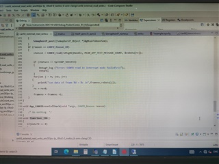

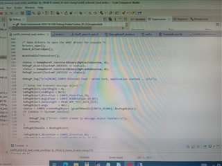

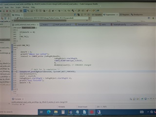

I am working with the CAN FD external read/write example on the AM263Px device using MCU+SDK 10.02.00.15.
I modified the example to:
  • transmit and receive data at 1mbps baud rate.
  • Transmit CAN FD messages every 1 second using a timer-based ISR.
  • Receive data using interrupt mode, with data sent from the PCAN-View application.
However, after making these changes:
  • No data is being transmitted or received.
  • Even when I bypass the timer and place the CAN_transmitMsg() function inside an infinite while(1) loop, the data is still not transmitted or received.
  • PCAN-View is configured correctly for CAN 1mbps

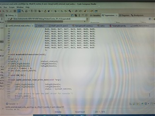

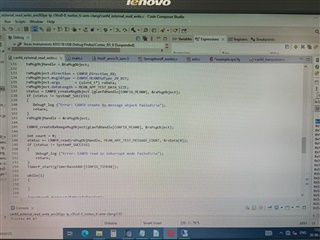

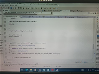

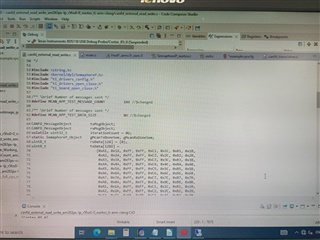

I have attached screenshots of the modified code for reference.

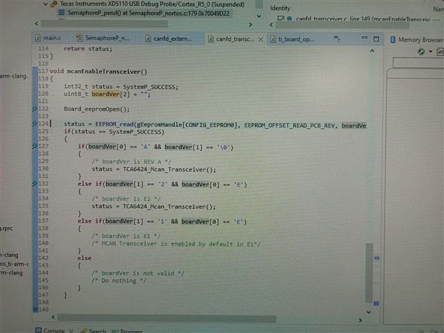

    What AM263Px board revision do you have? Also please show me where exactly is the execution stuck at inside the function. CCS step in snippet or any error message from the console will be helpful.
    Aswathi
  • Hii Aswathi,
    I am using AM263P4ACOMF ZCZ board. It is getting stuck at board version selection(attached the image). Which version i should choose.
    Sravanthi R.
  • Hi Sravanthi,
    What is the value of the array "boardVer" after it executes line 124? Because the MCAN transceiver needs to be turned awake using an STB signal. For different board revisions this signal comes from a different IO expander. That is the logic used in the image you shared.
    Also are you able to observe any signals on the MCAN header pins while executing the program? That will help understand if the transceiver was turned awake successfully or not.
    Aswathi

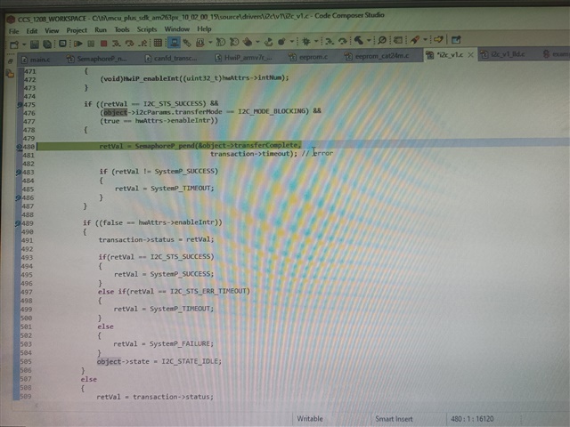

  • Hi Aswathi,
    1. Line 124 is not being excuted.Since the execution is halted in the I2C_transfer function( line 480 at SemaphoreP_pend( )). Attached the image.
    Sravanthi R.

    I have made the following changes and when i am trying to transmit the data for every 1ms using Timer and simultaneously receiving the data from the other node for every 10ms . Only the transmission is working but reception is not happening.In the same code if i disabled transmission and kept only for reception , then data is being received.
    Why transmission and reception is not working simultaneously.
    Attached the images of the code and system configuration.
    IMG_20250806_172139237-1.pdf
    Sravanthi R.
  • Hi Aswathi,
    In this case also i am receiving only 5 to 10 frames .. again no receive is happening. I have observed this for CLASSIC CAN at 1Mbps speed and CAN FD at 2 to 5 Mbps speed also.
    CCS: mcu_plus_sdk_am263px_installers\mcu_plus_sdk_am263px_10_02_00_15\examples\drivers\mcan\canfd_external_read_write\am263px-lp\
    I have used this code and modified main.c and canfd_external_read_write.c file as in above attached pdf.
    Sravanthi R.

    I modified the MCAN external read/write example so that it only receives frames, to check if transmitting causes any disturbance. I observed that the interrupt flags in CAN_IR are being set, but the interrupt callback configured for interrupt line 36( interrupt for MCAN)  is never called.
    Inside the callback I placed a function mcan_read() ( In this function, when a frame is received the FIFO level updates to 1 when data is received, so by polling it I can read the data using MCAN_readMsgRam()) ,to read the FIFO and acknowledge it. However, the callback itself is not triggered, even though the interrupt flags (CFG_IR ) are set when events occur (as configured in CFG_IE) and and RxFIFO0_status shows fifolevel as 1 and fifo full as 1.
    To test further, I moved the mcan_read() function into the while loop. With breakpoints, I see the FIFO level (updated in fifoStatus variable)  updates and the function executes correctly. But without breakpoints, MCAN_readMsgRam() is not executing since the fifolevel is not getting updated.
    I’ve attached both code versions for reference:
    • mcan_external_read_write_am263px-lp_r5fss0-0_nortos_ti-arm-clang → mcan_read() inside interrupt callback
    • mcan_external_read_write_interrupt_am263px-lp_r5fss0-0_nortos_ti-arm-clang → mcan_read() inside while loop.
      I am using MCU+SDK 10.02.15 , System Config 1.23.0 and AM263P4 LP.
    • AM263P4_MCAN.zip
    Sravanthi R.

  • Hello Madhurya,
    I took a look at the code you provided.
    You have defined APP_MCAN_FIFO_0_CNT as 0, this means that there are no enteries dedicated in MSG RAM to store messages in FIFO0.
    This is probably the biggest issue. I don't know how the status buffers are updating at all. I think that CAN RX Core is acccepting the packet, setting the flags, and attempting to store it in RX FIFO0, but since the size is 0, the message is essentially lost.
    Secondly:
    In the App_mcanIntrISR() function, you have replaced the following:
    static void App_mcanIntrISR(void *arg)
        uint32_t intrStatus;
        intrStatus = MCAN_getIntrStatus(gMcanBaseAddr);
        MCAN_clearIntrStatus(gMcanBaseAddr, intrStatus);
        if (MCAN_INTR_SRC_TRANS_COMPLETE ==
            (intrStatus & MCAN_INTR_SRC_TRANS_COMPLETE))
            SemaphoreP_post(&gMcanTxDoneSem);
        /* If FIFO0/FIFO1 is used, then MCAN_INTR_SRC_DEDICATED_RX_BUFF_MSG macro
         * needs to be replaced by MCAN_INTR_SRC_RX_FIFO0_NEW_MSG/
         * MCAN_INTR_SRC_RX_FIFO1_NEW_MSG respectively */
        if (MCAN_INTR_SRC_DEDICATED_RX_BUFF_MSG ==
            (intrStatus & MCAN_INTR_SRC_DEDICATED_RX_BUFF_MSG))
            SemaphoreP_post(&gMcanRxDoneSem);
        return;
    with:
        printf("interrupt occured");
        if (MCAN_INTR_SRC_RX_FIFO0_WATERMARK ==
            (intrStatus & MCAN_INTR_SRC_RX_FIFO0_WATERMARK))
           mcan_read();
           printf("interrupt occured due to rx fifo level");
        return;
    The key line here are:
    if (MCAN_INTR_SRC_DEDICATED_RX_BUFF_MSG == (intrStatus & MCAN_INTR_SRC_DEDICATED_RX_BUFF_MSG))
    vs
    if (MCAN_INTR_SRC_RX_FIFO0_WATERMARK == (intrStatus & MCAN_INTR_SRC_RX_FIFO0_WATERMARK))
    when it should be:
    if (MCAN_INTR_SRC_RX_FIFO0_NEW_MSG == (intrStatus & MCAN_INTR_SRC_RX_FIFO0_NEW_MSG))
    The rxFIFO0WaterMark macro is initialized to 0 in the MCAN_initMsgRampConfigParams() and is meant to be used a safeguard for FIFO overflow by alerting the user that a specified number of enteries are currently occuping the FIFO, meaning only a certain number of additional messages can be accepted into the FIFO before it overflows and begins to drop messages or overwrite previous messages (according to the FIFO operating mode - Blocking/Overwrite respectfully).
    By replacing this with FIFO0_NEW_MSG, you will ensure the mcan_read() function is executed on every accepted message and not just when the watermark # of messages are available.
    Zackary Fleenor
