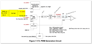

The description of the RDC in the TRM (7.5.3.2.2.1.2 Excitation Signal and PWM) gives the impression that the PWM excitation output is completely independent.
However, the diagram suggests that it is dependent on an external signals called Master_en, Sync_armed and Sync_in.
I cannot find further explanation of these signals in the TRM.
<Q1> Where do the signals (Master_en, Sync_armed and Sync_in) signals come from and are they mandatory?
<Q2> In the example 'resolver_angle_speed_am263px-cc_r5fss0-0_nortos_ti-arm-clang' I see the following configuration:
If I disable Sync IN, there is still an excitation PWM output. This give the impression, again, that RDC excitation is independent of any other peripheral.
Why do I still get an excitation output when this is disabled?
