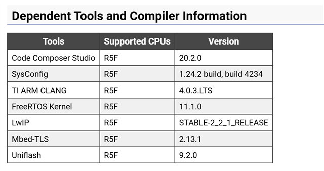

  • The only SDK I can find is mcu_plus_sdk_am263px_11_00_00_19 (with a 'p').  I downloaded and installed it but CCS does not seem to recognize it.
    Properties->General->Dependencies does not show it to me as an option.  Is that the correct SDK or is there something else I need to do to get the SDK recognized?
    I have restarted CCS but get the same results.
  • Please find the latest AM263x SDK here (MCU-PLUS-SDK-AM263X)
    MCU-PLUS-SDK-AM263X Software development kit (SDK) | TI.com
    Please find the latest tool version needed for this release
    Thanks and Regards,
    Nikhil Dasan
