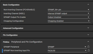

To use the GPAMP internally to buffer to the ADC, you will need to configure GPAMP_IN+, using up pin 30:
So as long as you do not need to pinout the OPA0 IN0+, you should be ok. If you need to, you could also reconfigure the pin at runtime to swap between the OPA and GPAMP depending on which peripheral is needed at that time.
