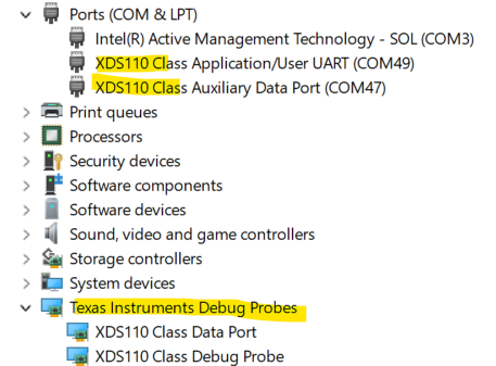

      There really isn't any jumpers or modification needed for the board to use an external debug probe. You simply just connect the XDS110 to U6.
      When you plug the XDS110 to the PC, do you see the probe properly enumerated? Use the Windows Device Manager to make sure it is enumerated correctly. You should see something like below. If you don't see them there is an issue with the probe. Try a different USB port or different PC or new USB cable. Does it make a difference?
      Do you have another LaunchPad you can try? This is to isolate if the problem is with the board. Your log shows that the JTAG scan-chain is broken.
