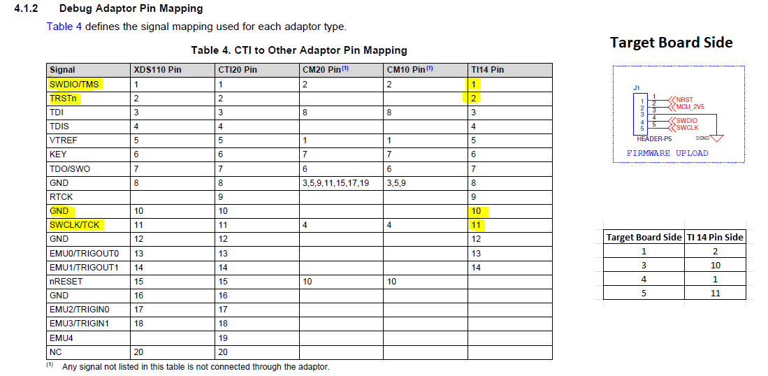

Good day TI Team,
Summary:
Regarding MSPM0L1306 programming/Debugging with operating voltage 2.5V using TI XDS110 Debug probe.
Please guide regarding connection between TI XDS110 Debug probe and target board with 5 berg pinouts
Details:
We purchased XDS110 Debug probe.
Based on understanding from XDS110 Debug Probe User's Guide,
For programming and debugging (using 2.5V),
We planned to connect target board with TI14 pin adapter of “XDS110 Debug Probe” as below:
For flashing,
We are not sure on connection of power supply input of 2.5V and its ground.
Please validate the above connection and guide us regarding signal connection + power connection between Target board and XDS110 Debug Probe.
Note:
Placed actual physical connection below for reference:
