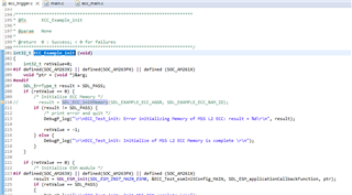

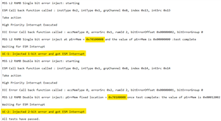

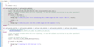

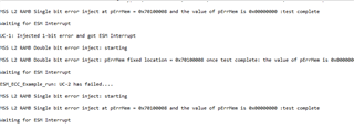

Hello Ti Team,
We are using AM2634 with custom hardware, in that we are trying to implement ECC Aggregator test. So, we took the example code "sdl_ecc_mss_l2_am263x-cc_r5fss0-0_nortos_ti-arm-clang" as reference and implemented it. In this program we are running into an issue where SEC, DED errors are only being detected if we are continuously refreshing that entire memory before injecting SEC or DED error. Is it possible for the error to be detected without refreshing the entire memory. If not, what is the minimum blocks from error injecting address that we need to refresh for the SEC/DED error to be detected.
