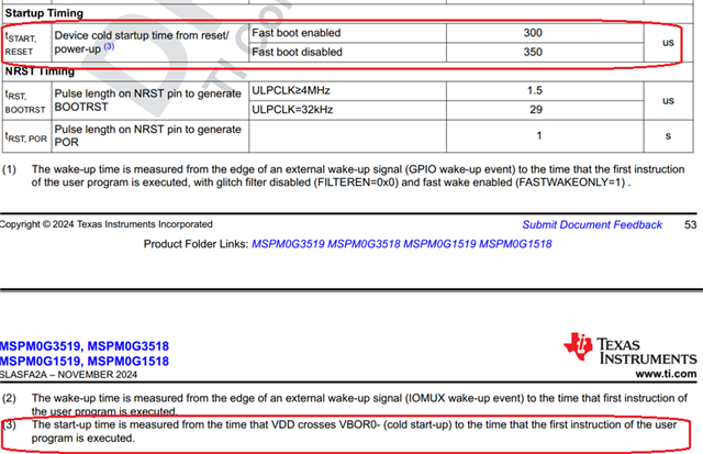

3. See attached screenshot from datasheet,
    For the "tstart" duration, does it include ROM boot process, like BCR, BSL ?
    What is "the first instruction of the user program" referred to as ? in BCR or customer main application ?
    What is the fast boot ? how to enable or disable it ?

    3. For "tstart" duration, it include ROM boot process, such as BCR.
         "the first instruction of the user program" referred to customer main application.
          "fast boot" : Please refer to 1.4.2.5 Fast Boot in MSPM0 G-Series 80-MHz Microcontrollers Technical Reference Manual (Rev. B). I will skip some steps in BCR to make the boot process faster.

    2. For "tstart" duration, does the typical value include "BSL" ?
        If CSC exists, "the first instruction of the user program" referred to customer main application or CSC ?

    2.1 No, it does not include BSL. BSL need some invoke signal to enter, by default it will not be entered.
    2.2 It refer to CSC in this case. (Actually the CSC could be considered as the first "application program" after ROM code, and it will have some security operation such as image verification before it jump to real application program).
