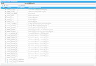

I was checking the svd files for the MSPM0 series and found some issues.
In all svd files I found that the ADC_MEMRES registers are missing, this includes G-series, L-series, H-series, C-series and MSPS003.
Also in the SAMPCLK of the ADC the enum sometimes switches the ULPCLK with the SYSOSC, which differs from the datasheet.
This SAMPCLK switch is in the MSPM0G110x, MSPM0G150x, MSPM0G310x, MSPM0G350x, MSPM0L110x, MSPM0L130x and MSPM0L134x families.
Would it be possible to check and correct them if you find these issues too?
