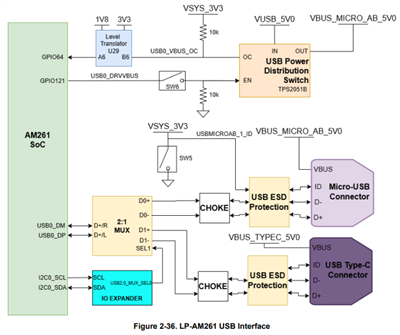

    AM261x devices use software to set whether or not a host is connected (TRM section 6.1.3.2.8 USB Global Configuration explains this some). For the actual physical connections, we use a USB Power Distribution Switch that feeds the VBUS signal from the USB connecter to a GPIO pin. You can see this connection in the LaunchPad User's guide:

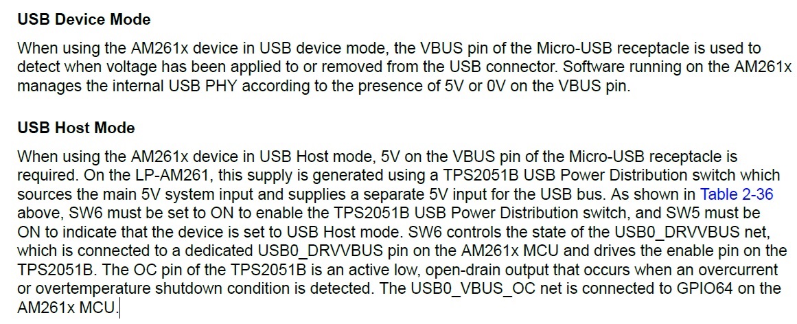

    Regarding the actual physical connections which you mentioned above, is it the connection from OC pin of USB Power Distribution Switch to GPIO64 on AM261x in the above Figure 2-36 ? They cannot find this description of USB Device Mode in the LaunchPad User's guide.
    According to the following description in the LaunchPad User's guide, this connection from OC pin to GPIO64 is used for overcurrent detection in the USB Host mode.
    This connection is used for the both USB host detection in the USB Device mode and overcurrnet detection in the USB Host mode ?

    I apologize, I had a few discussions with the EVM designers and with the software/SDK teams over this and learned that I was misinformed about the USB power circuitry. From those discussions, we concluded that our AM261x EVMs are not laid out to detect HOST connection.
    Speaking with the software teams, our USB drivers set VBUS_VALID as always HIGH, meaning that when in DEVICE mode, the AM261x USB controller considers the HOST always connected. It would be up to a user to make sure the HOST is connected before communication. This is unfortunately an oversight in our EVMs.

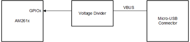

    For HOST detection, the implementation is the same as what I mentioned a few days ago:
    Connect the VBUS line from the USB port to a GPIO on the AM261x device, making sure to use a voltage divider to meet the input voltage and current limitations of the AM261x device.
    From there, you can choose to poll for a valid signal on that pin or set up an interrupt for any signal change to configure VBUS_VALID as set (for connected HOST) or cleared (for no connected HOST).
    The exact GPIO pin you choose is going to be entirely dependent on your application and what priority level you need/want for USB, and should be addressed separately.
    This is a very basic diagram showing the VBUS detection connection only:
