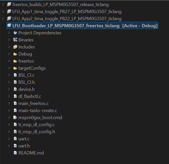

I am trying to use an example from the "MSPM0 Live Firmware Update (LFU) Bootloader Implementation" guide.
First, I flash the Bootloader code into the chip. Then, I used the Python-based PC software provided in the example files. But it cannot identify a UART signal from the chip. When I do test with the MSPM0G3507 launch pad, it works.

  • I resolved the above problem, successfully changed the UART pins.
    I also changed the LEDs to RGB in the application code for the MSPM0 launchpad and turned off the Red LED blink. But the Red LED blinking of the bootloader code is still working. I think the bootloader is still working in parallel with the application code.
    I also need to use UART communication in the application. How to do it while the bootloader is also looking for UART receive.
    I have uncommented these lines and modified the application as below. Then I can use UART for the application code. But I cannot wake the bootloader again.

    How to suspend the bootloader while running application codes, and wake when needed to update firmware.
    I also tried to create a new application code with .syscfg. Also added necessary things. It was downloaded properly through the GUI. But did not work.
    Please help resolve this.
