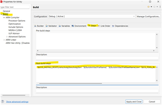

I want proper configuration for hex file generation in ccs 12 version. Right now, i'm using .bin file programming through Uniflash and it works fine, but soon after powering off the controller won't run any firmware(.bin).
From the Hex utility, generated hex file is not at all working i.e from uniflash it says program success but the MCU won't run.
Please provide the configuration required for executable file generations for release mode or production firmware flash.

      How did you generate the hex file?
      You need to use --romwidth 32 and --memwidth 32 flags so only one hex file is merged and produced. Refer to TI Arm Assembler user's guide for details. If this does not solve your problem, I will forward your question to our toolchain experts.
    How did you generate the .bin file?
    If you use any of the TivaWare examples, it will generate a .out file as well as a .bin file. For example, in the CCS post-build processing steps, it has the below commands to generate a .bin file. Are you using the same commands?
    "${CCE_INSTALL_ROOT}/utils/tiobj2bin/tiobj2bin" "${BuildArtifactFileName}" "${BuildArtifactFileBaseName}.bin" "${CG_TOOL_ROOT}/bin/armofd" "${CG_TOOL_ROOT}/bin/armhex" "${CCE_INSTALL_ROOT}/utils/tiobj2bin/mkhex4bin"
    When you said it does not run the firmware, do you have the same problem when you load the .out file instead? We need to isolate the problem (program won't run after a power cycle) if it is related to your .bin file generation or the firmware itself.
