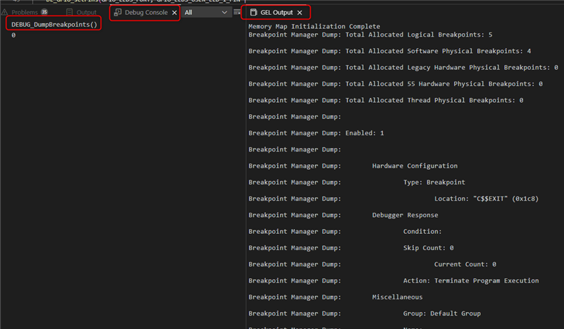

  • Having a little more visibility into which breakpoints are consumed by system functions could help.
    In the Debug Console view, can you run the below command:
    DEBUG_DumpBreakpoints()
    And check the GEL_Output view, check the output to see the status of breakpoint usage:
    Please copy and past the output to a text file and attach the file to this thread.
    ki
  • Hey Ki,
    I ran the command but it doesn't seem to produce any output:
    Munan

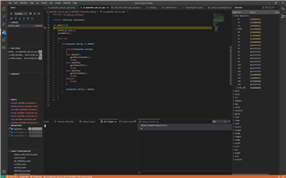

  • That is really odd. Can you provide a full screenshot of the entire IDE? What exact CCS version is being used?

  • Thanks. I found some strange behavior. It is likely what you are experiencing also.
    Can you remove all breakpoints and then terminate the debug session. Then start a new one. Then run the "Debug_DumpBreakpoints() in the Debug Console BEFORE you set any breakpoints and see if you see any output. If you do, then set some breakpoints and see if you still see output.

  • Hi Ki,
    OK yes setting breakpoints after starting the debug session seemed to fix the issue and now I get output on the DEBUG_DumpBreakpoints() command:
    Munan
