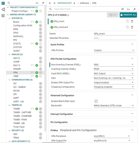

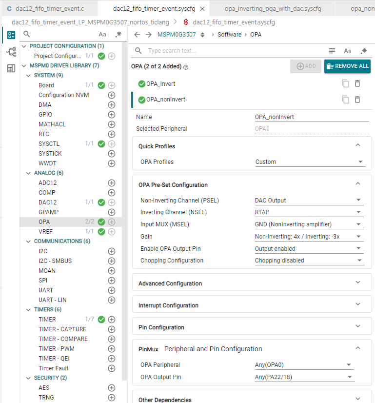

I'd like to amplify DAC output with OPAMP.
I wanna make 2 pulse.
1. Non inverted - work well
2. Inverted - X. No output pulse.
Could you the problem?
What should I have to change to fix it?

Hi Ryan,
For the invert input of OPA from DAC, I think you could refer to this SDK example:opa_inverting_pga_with_dac

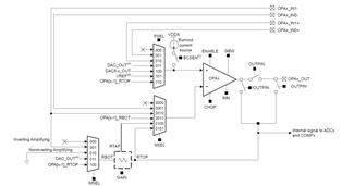

Hi Pengfei,
Thank you for your answer.
I also referred that example. But it doesn't work(doesn't amplified).
Also, I can't make sense the example's PSEL, NSEL, MSEL connection in non-inverted example.
Could you please check it one more?
Thank you
Hi Ryan,
From your second configuration, it seems want to get a negative voltage output, and will be out of the 0-VCC range.
What is you purpose of second case, and what is your desired output corresponding to DAC output.
