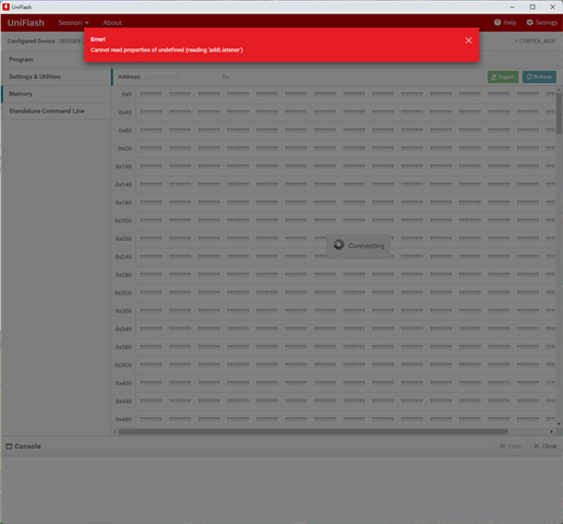

    I also tried to take a memory dump of the MCU and save it to a file using the UniFlash tool, but it keeps on crashing as shown in the attachment.

  • I also tried to take a memory dump of the MCU and save it to a file using the UniFlash tool, but it keeps on crashing as shown in the attachment.
    Try twice or 3 time to see if there is any error.
    It quite common that first read using Uniflash not working.
