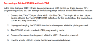

While updating the XDS110 firmware, my board seems to have entered a bricked state. I attempted to use the recovery procedure mentioned in the XDS110readme.txt document. However, I'm encountering an issue where the xdsdfu.exe tool opens and immediately closes without allowing any interaction.
Could you please guide me on how to recover the board and bring it back to a working condition?
