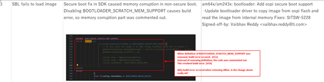

    We believe you are referring to the addition of the following code in the sbl_ospi example main.c:
    /* This buffer needs to be defined for OSPI boot in case of HS device for
     * image decryption and authentication
     * The size of the buffer should be large enough to accommodate the appimage
    uint8_t gAppimage[0x800000] __attribute__ ((section (".app"), aligned (4096)));
    bootConfig = (Bootloader_Config *)bootHandle;
    bootConfig->scratchMemPtr = gAppimage;
    This change appears to be relevant only for HS devices, and unnecessary for HS-FS devices.
    In our case, we are using HS-FS devices, so we would like to disable this logic. Our concerns are not only about increased memory usage, but also about the impact on boot time due to additional memory handling during the boot process.
    Is there a recommended way to disable BOOTLOADER_SCRATCH_MEM_SUPPORT for HS-FS devices, either through SysConfig or compile-time flags?
    I see that you have reverted back to V10 code for issue number 2 and 4 for OSPI, you ideally shouldn't face any issues, could you elaborate what issues you are facing due to this and how you were able to identify that this piece of code causes this issue, so that I can route this query to our OSPI expert and he can help your further.
    We reverted to MCU+SDK v10 code for certain OSPI functions because the Winbond flash memory (W35T25NW) that was previously working with v10 no longer operated correctly after upgrading to v11.
    We identified the problematic area by comparing the differences in OSPI-related source files between SDK v10 and v11. After restoring the v10 implementation, the flash memory resumed normal operation.
    A.Tamura.
    This is enabled using this macro in bootloader_soc.h: https://github.com/TexasInstruments/mcupsdk-core/blob/next/source/drivers/bootloader/soc/am64x_am243x/bootloader_soc.h#L45
    You can remove this definition if you want to disable the scratch memory support.

    No. 2 and 4   OSPI Flash 8d-8d-8d failure
    No.3 Build error when BOOTLOADER_SCRATCH_MEM_SUPPORT is defined
    Kasai
    There is a better way to disable scratch memory usage for a particular bootloader instance, please refer to this thread:
     RE: MCU-PLUS-SDK-AM243X: Disable Bootloader scratch memory - BOOTLOADER_SCRATCH_MEM_ENABLE define
    Meet.

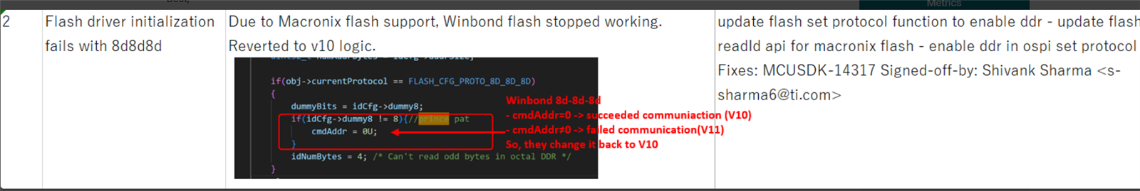

  • Hi Tetsuro,
    Thanks for waiting.
    For the two changes you have shared: cmdAddr = 0 should work for you as the flash that the customer is using, must have the cmdAddr required to be 0 and not any other value while reading the device id and manufacture id. Please share the flash datasheet for me to confirm this.
    For the OSPI_lld_enableDdrRdCmds, it is setting the bit for DDR rd cmds to 1. I have tracked the changes and the owner for the same. Once the owner is back from sick leave, I will update you with the intention behind the change and if it can be avoided for the flash you are using.
    For the second point you mentioned, Meet has responded with a thread link. Please have a read through it.
    Vaibhav

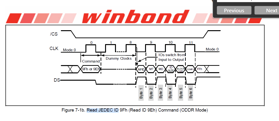

  • Hi Kasai,
    For your flash, I referred the section for reading jedec id via 9Fh command.
    The snippet of that is shown here:
    Please tell me the value of idCfg->dummy8 which is used inside Flash_norOspiReadId, assuming your mode of operation as 8d-8d-8d?
    Vaibhav
  • Hi  ,
    The value of dummy8 is "8".

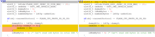

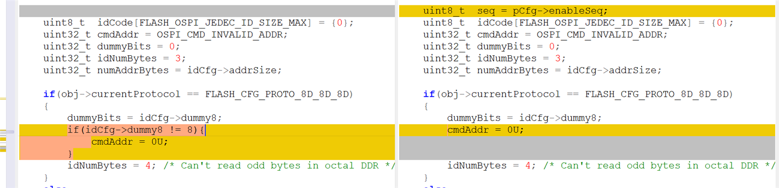

    So in the SDK 10 vs SDK 11 the following difference is there:
    So you are saying that code is reverted back to SDK 10, to resolve the issue.
    This would mean that cmdAddr = OSPI_CMD_INVALID_ADDR in SDK 10
    And
    cmdAddr = 0 in SDK 11
    Based on your explanation in the excel sheet, when cmdAddr  = 0 then it is successful.
    That would mean SDK 11 is good for you right? and not SDK 10.
    Attaching the relevant screenshot you wrote in excel.
    Please clarify the above.
    Vaibhav
  • Hi Vaibhav,
    Sorry for taking time.
    I checked with customer.
    In their settings, dummy8 is "8" and cmdAddr should not be 0.
    In V11, cmdAddr becomes 0, no matter what dummy8 is.
    In V10, cmdAddr is not 0, when dummay8 is "8".  This is what customer want to do. So, they changed the v11 based code to v10.
    Here is the question.
    [Question]
    Wny "if(idconfig->dummy8 !=0{" was remove in V11 although V10 had.
    Why

  • Hi Tetsuro,
    I believe there is a Macronix flash MX25UW64 on the AM261x-LP TI EVM. In Octal Mode, this flash(requires 8 dummy cycles in octal mode) and cmdAddr value of 0. Hence, the SDK update/commit was made in such a way to accommodate one of many such flashes on the AM2X EVMs.
    I understand this is breaking the customer's flash logic, as they require cmdAddr to be invalid in order to read the device and manufacture id.
    Currently this tweak is okay for the customer to make, as the flash they are using is currently not tested on one of our TI EVMs. I also understand that the driver should be generic to all flashes out there. But, in this case, since we have not tested out with Winbond flash(due to it not being on the AM2X TI EVM) we see this driver update in Flash_norOspiReadId.
    I will check with the SW team to narrow down this reading procedure in such a way that it is generic to most flashes.
