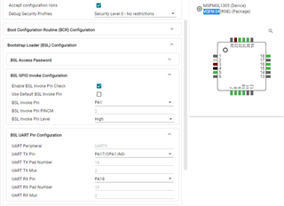

We use MSPM0L1305-Q1 for in-vehicle projects. The BSL upgrade function was used in the project, and the configuration is as follows. We discovered the following problems during the development
1. If the firmware is fully transmitted via BSL each time, it can be upgraded repeatedly
2. If the firmware transmission is interrupted during the BSL upgrade process. Then, after the reset is completed, the BSL upgrade still cannot be carried out. The chip must be powered off and then restored to BSL.
We are quite puzzled about the fact that the chip's state still cannot be restored after a reset.
PS: Chips are used in automotive components and cannot be powered off at will
