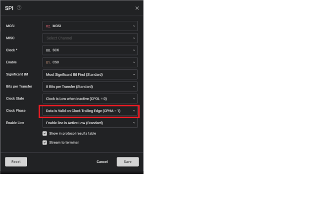

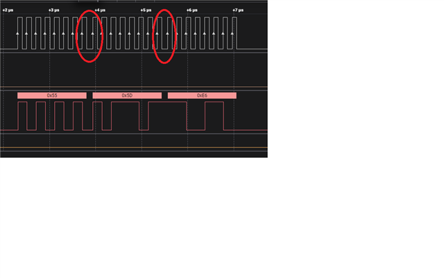

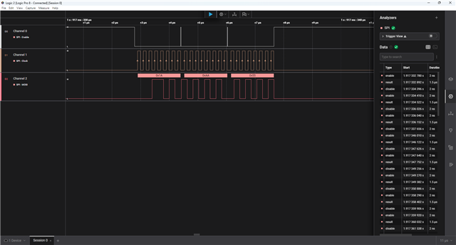

    However, If I input 0x1AAA55, on the Saleae Logic 8, I will see the 0x1A552A.

    One more observation to share with you. On the Saleae Logic 2, the total 24-bit CLK is not perfect smooth or continuous. There are a bit delay or gap between the 8th and 9th, 16th and 17th CLK. Or there are delay or gaps between each Byte. I guess that may cause the MOSI data shift. Right now I use 3 pin mode SPI. Should I change to 4 pin mode? After that mode changing, can I get the smooth or continuous CLK?
    Thanks and best regards,
    Lin

  • Hi Ming,
    FYI, I'm using the Saleae Logic 2.4.29 SW. My current data sample rate is 125 MS/s under the Device Settings.
    Here are my Saleae capture files with input 0xAABBCC and 0x010203 at 125MS/s and one at 500 MS/s. With the 500MS/s sampling rate, CS0 signal looks like not correct and MOSI data can't be decoded.
    I tried to upload capture files, but failed. Here I share my google drive link hope you can get it. If not, please let me know.

  • Hi Ming,
    I changed SPI setting from 3-pin mode to 4-pin mode (without GPIO). And repeated my tests got following results:
    When input 0x010203, Saleae captured and decoded as 0x008101.
    When input 0xAABBCC, Saleae captured and decoded as 0x555DE6. The data is not correct, with one-bit shift, but the results is consistent or stable not like the 3-pin mode the data was changing.
    Another observation is that CS signal extended some period, not 24-bit, causing some extra bits of CLK at the end, but that doesn't affect the MOSI decoding results.

  • Hi Ming,
    For the data results, looks like the MOSI data is not ready when the first rising edge of CLK coming, 0x010203 => 0x008101 and 0xAABBCC => 0x555DE6,  just one bit delay. Any hint or suggested solution?
    Lin

    One more test result to share with you.
    I verified the one bit shift by changing the mode from 0 to 1, CPOL = 0, CPHA =1 as shown in screenshot, and get the correct decoded data. I mean 0x010203 => 0x010203 and 0xAABBCC => 0xAABBCC.
    However, our peripheral SPI devices, such as LMX2595, are all in mode 0, CPOL = 0, CPHA =0. How can we modify controller SPI in AM273x side to meet the requirement?
    Lin
  • Hi Ming,
    Sorry for sending your too many messages today, as i'm blocked by this SPI issue so felt pressure and wanted to catch up a bit.
    As I sent out the last message, I should come to some kind of solution. However, I'm kind of hurry and not in good condition. So it's delayed to have the results. The main finding is as below. The SPI mode between AM273x EVM and Saleae Logic 2 does NOT match. The relation is as below:
    AM273x EVM                                       Saleae Logic 2
    Mode 0 (POL0 PHA0)                          Mode 1 (CPOL=0 CPHA=1)
    Mode 1 (POL0 PHA1)                          Mode 0 (CPOL=0 CPHA=0)
    Mode 2 (POL1 PHA0)                          Mode 3 (CPOL=1 CPHA=1)
    Mode 3 (POL1 PHA1)                          Mode 2 (CPOL=1 CPHA=0)

  • Hi Lin,
    I also confirmed that the issue is with the SPI mode 0. When I change to mode 1. It works perfectly.
    I know the AM273x EVM SPI modes are matching your description. I also confident what AM273x EVM doing is correct. I do not know what the Saleae Logic 2 is doing.
    Ming
  • Hi Ming,
    Thanks for your confirmation.
    May I know if you can get and open my Saleae capture files those I sent in the previous messages within the Saleae Logic SW? I wanted to make sure in the future we can exchange/share the results and status in that way.
    In addition, I have questions about your confirmation SPI signal capture. I saw two pulses in the SPI enable/CS signal and SPI CLK signal also has some delay between bytes. Will those be potential problems/issues for the SPI communication? Or they are acceptable.
    Lin
  • Hi Lin,
    Yes. I can open your *.sal file.
    The CLK pauses between the bytes is OK.
    Ming
