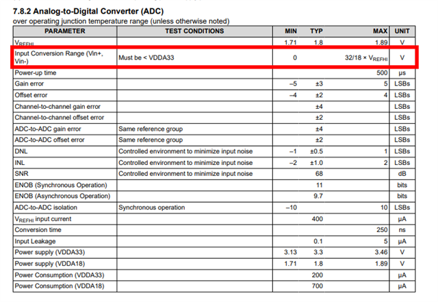

Part Number: AM263P4
Hii
The ADC input conversion range is from 0 to 3.3v right?
I want to know the maximum withstand capability of the adc input pin.

Hello Geetha,
Appologies for the delayed response while I was OOO last week.
This information is found in the ADC electrical characterstics section of the datasheet.
The voltage on an ADC input must not exceed the value of VDDA33.
