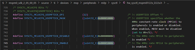

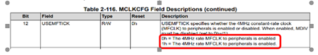

Hi Experts.
Regarding TRM of MSPM0 L-Series 32MHz Microcontrollers.
Both 0 and 1 mentioned enableed. Is 0 disable?
