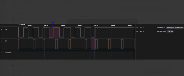

I have configured the RTC for 15.6 ms using RT1P0 prescaler & enabling respective ISR bit
I wanted to reset this timer & start again from 0 in some another ISR routine. I didn't not find any specific register for this setting. Can you please help here.
Also during run time, I wanted to reconfigure the RTC to some another time period of RT0P0, is it possible. What all configuration I will take care to do so?
Do we have any demo example?

  • Thank you for your reply. But this doesn't solve my query

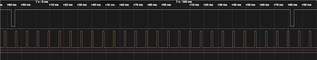

    In below image white line indicates - > external interruption that will execute RTC reset.
                             Brown line - > has RTC interruption.
    When an interrupt signal is received on the white line, we expect the RTC to reset and generate an interrupt on the brown line after 15.6 ms.(or the time configured for RTC) However, the RTC does not appear to respond to the white line signal, and the reset code provided seems to have no effect.

  • I missed to put value for RTC_CurrentConfig it should be as below
    RTC_config_s RTC_CurrentConfig = {
    RTC_IP_RT0,
    RTC_RT0IP_7_81MS, // this prescaler is to be configured after RTC reset happens
    Please check & kindly reply.

    Sorry for the late update.
    I have run some test. I can reset the RTC module and hold it successfully in my test code below.

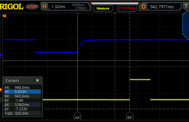

    It shows the RTC module requires around 8ms between the RTC enable to the 1st RTC interrupt. I am not sure why. But it looks like a stable delay required by the RTC module.

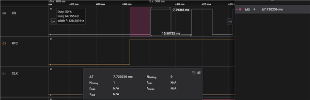

  • Hello Cash, also from above image looks like RTC is initialized for 15ms, but the distance between Timer ISR & RTC ISR after RTC reset is 8ms only. which is not correct. The actual requirement this distance also should be 15ms, as we are resetting the RTC
    Please can you re-check on this as priority. (in my start up description I mentioned 15ms , but in code I am initializing RTC as 7.81 ms~ 8ms, may be this has caused the confusion.)
    The requirement is whatever we initialized RTC prescalar ( e.g 15ms) , the distance between other TWO ISR's after RTC reset shall be same as configurations (i.e. 15ms)
    Also, from above Image it looks like RTC counter is not getting reset even after RTC reset

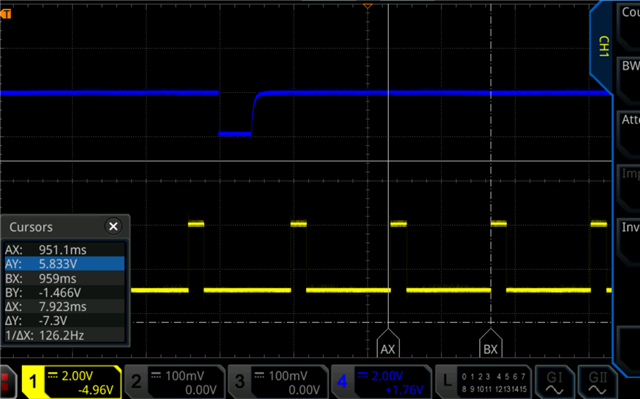

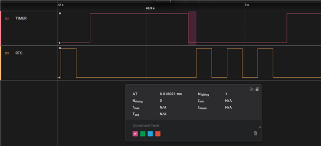

    I have run more tests with this 8ms of the first interval. It seems like this 8ms only happens on Periodic Alarm 1. The Periodic Alarm 0 is fine without encountering this issue. And no matter what period is set for the Periodic Alarm 1, the first interval is always shrunk 8ms.
    I also find that this Periodic Alarm 1(RT1PS) is source from a 128Hz clock output from RT0PS. 128Hz relates to 7.8125ms as period. It is quite close to the delay we observed.
    So, I am thinking that the RT1PS initial status is 1 instead of 0 for some reason and causes this time shrunk on the first interval.
    I would suggest to use a timer instead of RTC to generate a static periodic signal. I am also going to check with the team about this behaviour.

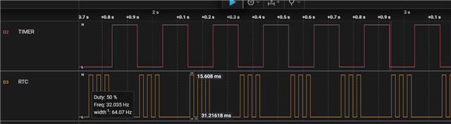

  • Thanks, the problem is we are using Standby mode as per requirement. In standby only two timers are availed TIMG0 & TIMG8 which are already occupied for another priority use cases for some pattern generations. Hence option is only the RTC.
    Ideally, I am looking for some configuration setting to reset the RTC counter, to start it from zero.
  • You can use Periodic Alarm 0 for instead to avoid this issue. I do not think there is a way to reset the RT1PS. For some guessing, I think during the initialization of the RTC module, there is a pulse generated on the RT0PS 128Hz output, and the RT1PS takes that pulse as clock source and count to 1.
  • I tried already for RTC_PSCTL_RT0IP_DIV256 (  Divide by 256 - 7.81 ms) but still same issue , I am not able to reset it , whereas after reset 1st ISR always comes less than whatever we configured, in below case its 3ms. So its still not helpful.
  • I do not see this issue on RT0IP_DIV256. The first interval is around 7.8ms as expected. And even though if the RT0IP also has the same issue and it count start from 1 instead of 0. It is hard to observe for us since its clock source is 32768Hz and one missing period is about 30us.
  • Yes this is at the start point, but if we reset & initialize it back it won't give 7.8 ms but less than it. Can you please check this scenario also.
