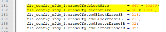

    Q) is above inputs based on FLASH device?
    In MCAL block size is set to 64KB not 128KB
  • Hi Hari,
    The second snippet is from the Fls_Nor_Config.c file right?
    I think you are referring to V0 or V1 folder. For AM263P, it is V2 folder.
    Please see the config file in V2 folder.
    You can see the block size is 128KB (131072 bytes).

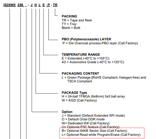

    Have few queries below, as per below image, FLS driver supports 4KB or 128KB erase size
    Q) If i configure erase size is 64KB, is is no problem right?
    Q) is FLS driver support 4KB/32KB subsector and 64KB/128KB sector size?
    Q) Should i use Fls_SetEraseType(FLS_BLOCK_ERASE); to erase 64KB/128KB sector size?
  • Hi Hari,
    This functionality depends on the variant of the ISSI. In datasheet it is mentioned that this supported by ISLX256/128 - B variant of flash. The OOB flash does not have this.
    The FLS driver supports 4KB subsector erase and 128KB sector erase.
    Yes, You would need to set the erase type as BLOCK erase to perform 128KB erase.

  • Hi Hari,
    Can you let me know which flash part are you using? Can you share full part number.
    Aswin
  • Hi Hari,
    There is no use, if i configure erase/sector size is other than 4KB/128KB right?
    ISSI flashes either supports 128KB or 64KB sector erase. That property depends on the flash variant being used, like how it is given in the screen snip above.
    Since 128KB erase is happening currently, then 64KB erase size cannot be configured on flash. This means that the ISSI flash under consideration supports 128KB sector erase.
    Even if you change the sector size as 64KB, this won't be possible as that is a property of flash.
    Aswin

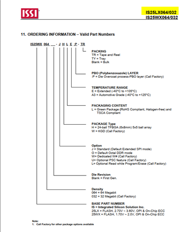

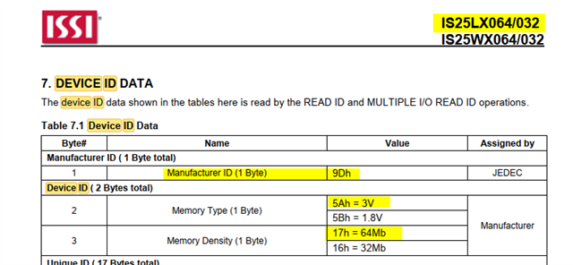

  • Hi Aswin,
    Following hardware is connected to our test system
    As per the user guide
    OSPI device as below
    From device datasheet
  • Hi Hari,
    I checked the SFDP table and it indicates that the flash as 128KB block. This can be checked by running the OSPI diagnostics example.
    The example and found in MCU PLUS SDK: examples/drivers/ospi/ospi_flash_diag
    The datasheet never lists a standard part number for 64KB erase even though in the foot notes it is mentioned as optional.
