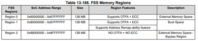

Our team is currently developing the SBL software and would like assistance with the following questions.
  1. Will the ECC bits are enabled by RBL development boot mode(debug)?
  2. What is the behavior when ECC fails when RBL is running?
  3. During a data abort exception, how can one differentiate between a double-bit error and an inject-only mode trigger?
  4. As per Section 5.9.2 Logger, the RBL uses the logger module for debug information. How can the detected failures be transmitted to the SBL so that it is aware of a failure scenario in the RBL?
  1. As per Section 5.9.2 Logger, any failures detected by the R5 or HSM during boot can lead to an SoC warm reset after 180 seconds. Can this timeout be reduced based on our requirements?
  2. In the logger module, what types of failures can the RBL log?
  1. Need some good understanding on PBIST.
    1. Is PBIST configured and enabled only by the ROM bootloader?
    2. What is the behavior/action of RBL If PBIST finds failure in TCMB or TCMA or L2 memory? Will it get stuck in RBL in such failure scenario?
    3. If SBL can initiate PBIST, how can it test TCMA and L2 memory regions without causing any memory corruption?

  • As per Section 5.9.2 Logger, the RBL uses the logger module for debug information. How can the detected failures be transmitted to the SBL so that it is aware of a failure scenario in the RBL?
    If there are any errors in the RBL, the SBL would not come up at all. Hence, we have this logger memory to understand the cause of error in ROM.
    No, this timeout is fixed to 180 seconds. This is an HSM Watchdog which would be disabled once the customer HSMRT is loaded and both the MSS ROM and HSM ROM are eclipsed. So in SBL, you can configure the R5 Watchdogs as per your requirements.
    It would mostly be failures in either certificate validation or SBL integrity check failures or PBIST failure on the MSS ROM side which could be seen using this logger info.

  • Hi Deviprasad,
    Apologies for the delayed response!
    For OCRAM the ECC will always be in enabled mode only. For external flash need to enable it manually.
    You can refer below link to understand on how to enable ECC for OSPI:
    AM263Px MCU+ SDK: Enabling safety on external flash
    Thanks & regards,
    Jagadish.
