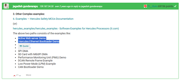

  • Hi Anvesh,
    Apologies for the delayed response, i was off for few days due to personal work.
    We have several tested ethernet examples here in below FAQ:
    I am suggesting you refer them once.
    Is it possible to share your code for testing at my end?
