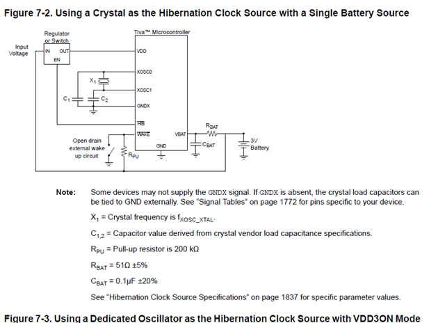

Do any of the TIVA parts have VBAT available but do not require the external hibernation logic?
TIA,
John

Hi John,
Yes, The Tiva family of MCUs (both TM4C123 and TM4C129) have integrated Hibernation module. See below example diagram.
