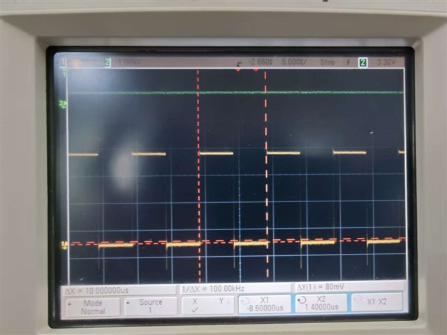

I defined a key command. After clicking the key, the DMA instruction for moving the array will be triggered and output through TIMER_PWM. The communication rate is 5us per bit, with a transition every 5us. Maybe there is a problem with my configuration in CCS_config. I don't know why the waveform I want to send doesn't appear. Instead, a repetitive waveform shows up and the sending doesn't stop. It doesn't end the sending after moving all the data in my array,Could you provide a successful example of sending a 5us pulse change for me to refer to when configuring CCS_Config?

  • I use button presses to control the sending of instructions for Manchester communication. I store the instructions 0, 1, 0, 1, 1, 0, 1, 0, 0, 1, 0, 1 in an array for sending. Since a 5us low-level to 5us high-level transition is considered as a high level, and vice versa for a low-level to high-level transition, I want to output different waveforms using PWM. However, the current phenomenon is abnormal. That's it. I hope to achieve the following: when my button is pressed, DMA will transfer the specified waveform from my array to timer_PWM for output at a rate of 100k, and stop sending after the output is complete.
  • I am still not clearly understand what the PWM control will be like. For example 0: means 20% duty cycle PWM with 1 cycle. 1: means 60% duty cycle PWM with 1 cycle. If you only need one cycle PWM signal, I would suggest you to use other methods to realize.

    Just as I wrote, however, currently I'm using the timer's interrupt to periodically toggle the IO port. I control the duration of the IO port toggle to achieve the waveform I want, such as a 5us high level to a 5us low level, and it can freely toggle. So, there is a drawback to this approach, which is that the toggle speed of the IO port is not sufficient. Therefore, I need to use DMA to transfer the data to timer_PWM. This way, the CPU does not need to be involved, and it should enable faster communication. What I'm doing at this moment is equivalent to simulating a DMA. I don't know how to configure DMA in CCS to transfer the data in my array to achieve different high and low level toggles,thank you.
  • Can you refer to the code example I shared with you. Then you don't need to use interrupt.
