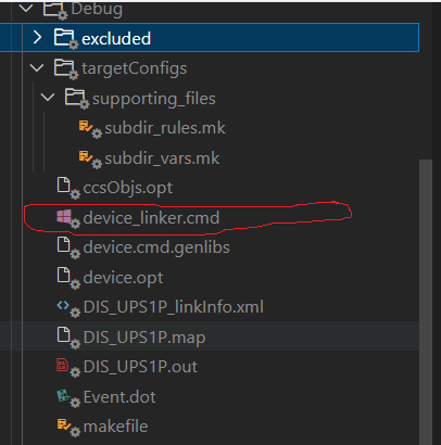

    I placed below code in device_liker.cmd file
    MEMORY
        FLASHVEC        (RX)  : origin = 0x00000000, length = 0x00000400 //intvecs must always point to 0x0
        USER_VARIABLES  (RW)  : origin = 0x00000400, length = 0x00000800
        FLASH           (RX)  : origin = 0x00000800, length = 0x00020000
        SRAM            (RWX) : origin = 0x20200000, length = 0x00008000
        BCR_CONFIG      (R)   : origin = 0x41C00000, length = 0x00000080
        BSL_CONFIG      (R)   : origin = 0x41C00100, length = 0x00000080

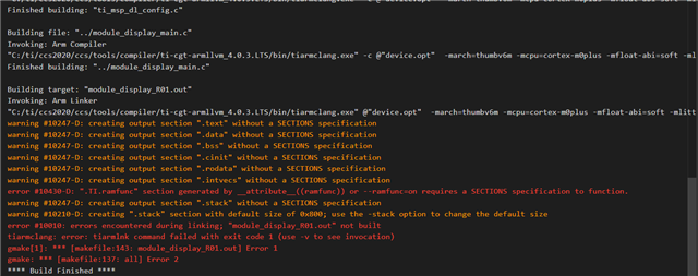

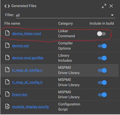

    It is automatic replaced back by syscfg as I build it again. Now I stop auto update as below.
    But building project have errors..
    I think I am missing some more step to follow or I am placing suggested flash change at wrong place. Could you please write all missing steps in details ? How to use  "USER_VARIABLES  (RW)  : origin = 0x00000400, length = 0x00000800" in my mains code?

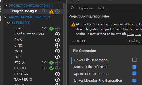

    You need to stop syscfg from generating the linker file. See below for an example.

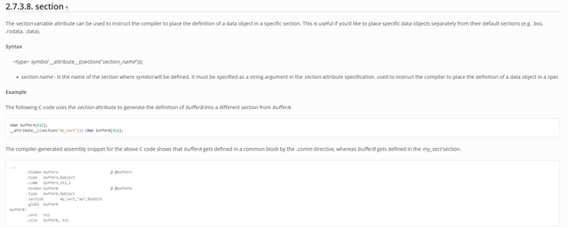

    As for placing the variable in the correct section --> Take a look at this document. It has examples that show various different types of "attributes" that can attached to objects.
