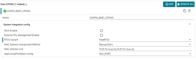

I'm trying to run the example available in SDK11 that runs MQTT client on this board (for reference i put it here). From sysconfig i removed EEPROM and related I2C used to access it. On CPSW settings, in "System integration config -> MAC Address Assignment Method" I set "Manual entry". However, when I compile the project, files generated form sysconfig keep trying reading the EEPROM. The result is that build process fail throwing the following errors:
  • use of undeclared identifier 'CONFIG_EEPROM0' ti_board_config.c /cpsw_lwip_mqtt_am243x-evm_r5fss0-0_freertos_ti-arm-clang/Debug/syscfg line 334 C/C++ Problem
  • use of undeclared identifier 'gEepromHandle'; did you mean 'gUartHandle'? ti_board_config.c /cpsw_lwip_mqtt_am243x-evm_r5fss0-0_freertos_ti-arm-clang/Debug/syscfg line 327 C/C++ Problem
Hereafter a copy of sysconfig that I'm using and a screenshot of the setting that I change in CPSW:
 * These arguments were used when this file was generated. They will be automatically applied on subsequent loads
 * via the GUI or CLI. Run CLI with '--help' for additional information on how to override these arguments.
 * @cliArgs --device "AM243x_ALV_beta" --part "ALV" --package "ALV" --context "r5fss0-0" --product "MCU_PLUS_SDK_AM243x@11.00.00"
 * @v2CliArgs --device "AM2434" --package "FCBGA (ALV)" --variant "AM2434-D" --context "r5fss0-0" --product "MCU_PLUS_SDK_AM243x@11.00.00"
 * @versions {"tool":"1.24.1+4189"}

const enet_cpsw       = scripting.addModule("/networking/enet_cpsw/enet_cpsw", {}, false);
const enet_cpsw1      = enet_cpsw.addInstance();

enet_cpsw1.$name                        = "CONFIG_ENET_CPSW0";
enet_cpsw1.PktInfoOnlyEnable            = true;
enet_cpsw1.mdioMode                     = "MDIO_MODE_MANUAL";
enet_cpsw1.LargePoolPktCount            = 40;
enet_cpsw1.macAddrConfig                = "Manual Entry";
enet_cpsw1.MDIO.MDC.$assign             = "PRG0_PRU1_GPO19";
enet_cpsw1.txDmaChannel[0].$name        = "ENET_DMA_TX_CH0";
enet_cpsw1.rxDmaChannel[0].$name        = "ENET_DMA_RX_CH0";
enet_cpsw1.rxDmaChannel[0].PacketsCount = 40;
enet_cpsw1.rxDmaChannel[0].macAddrCount = 2;
enet_cpsw1.netifInstance.create(1);
enet_cpsw1.netifInstance[0].$name       = "NETIF_INST_ID0";

Could someone explain what I'm missing to get completely rid of this EEPROM?
