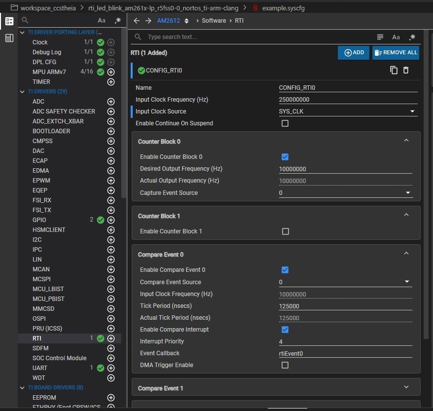

They’re evaluating the timer interrupt with the following configuration, and observing the period of timer interrupt by using the oscilloscope. It’ll be 125us period of timer interrupt.
When AM2612 is booted up with DEVBOOT mode, they can observe 125us period of timer interrupt as they expected.
However, it’ll be 1,250us when it is booted up with OSPI BOOT mode. It is 1,000 times longer period than they expected.
Do you have any solution to solve this issue ?

    I have root-caused the issue. Below is the issue summary and fix:
    1. The RTI configuration for RTI instances  was being done incorrectly by the syscfg auto-generated code. Specifically, the auto-generated code used an address which was incorrect, so the default clock source (WUCPUCLK of 25MHz was being used). Even though we had configured it to be 250MHz, since the clock source selected was 10x lower in frequency, the time period was 10x higher (125us to 1250us)

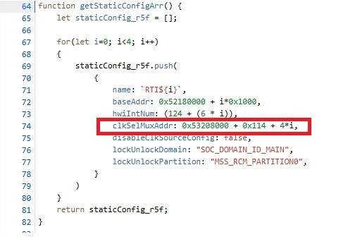

    2. The below highlighted line in the image (in red) is calculating the address incorrectly in mcu_plus_sdk\source\sysconfig\drivers\.meta\rti\soc\rti_am261x.syscfg.js
    This line number 74 needs to be updated to:
    clkSelMuxAddr: 0x53208000 + 0x140 + 4*i,
    After making the above change, please re-open your syscfg, check the configuration, save it and re-build your application.
    Then check the ti_drivers_config.h file generated and verify that the CONFIG_RTI0_CLOCK_SRC_MUX_ADDR  is defined as 0x53208144h and not 0x53208118u
    The issue was not observed in gel scripts based DEV Bootmode approach because we set all the clock sources to be SYS_CLK by default at correct addresses, and in-case of SBL-OSPI, post SBL we relied on application to do the RTI1 configuration, which was done at incorrect address.
    I have locally tested with the above change and am able to see a consistent 125us gap between interrupts now in both DEV as well as OSPI boot-mode. I’ll raise a bug and get this fixed in the MCU_PLUS_SDK as well.
